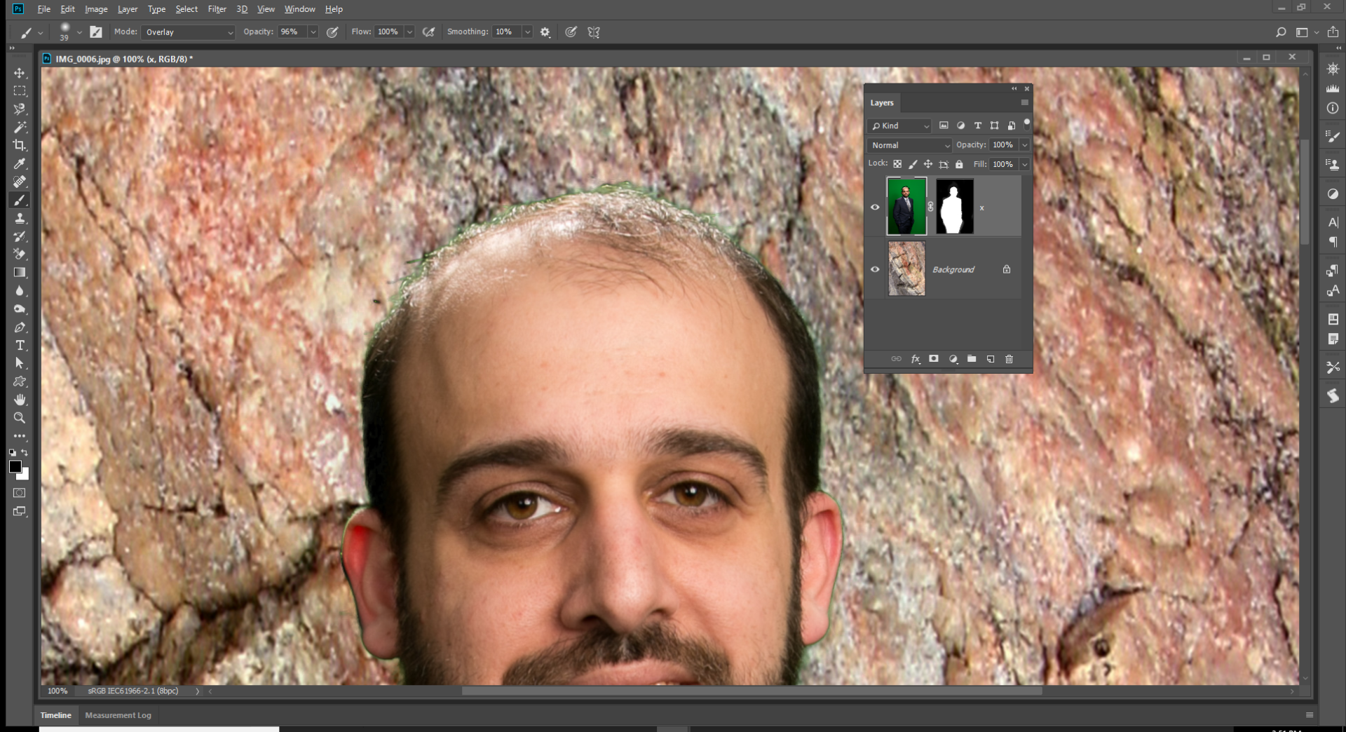

The others showed how to remove the background. D.Fosse showed that select color range works well for this. To sharpen up the mask you can brush with white and black directly onto the mask with the brush in overlay mode.
To remove the green color contamination, add an empty layer above the masked subject. Set that empty layer to color blending mode. Alt Click on the border between the two layers, in the layers panel, so that a small down arrow appears. This clips the new layer so brushing on it only shows where the pixels are not masked in the layer below.
Now take a small soft brush and Alt click to pick up colour from the subject and brush over the green edges.
