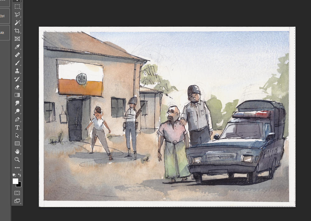

Explorer ,
Mar 15, 2022 Mar 15, 2022
Thanks. This seems to have helped a lot. I've done all of these steps except for the auto align layers feature (which I wasnt aware of). I might add a tiny bit of surface blur as well just to smooth it out a bit more but this is a step in the right direction.
