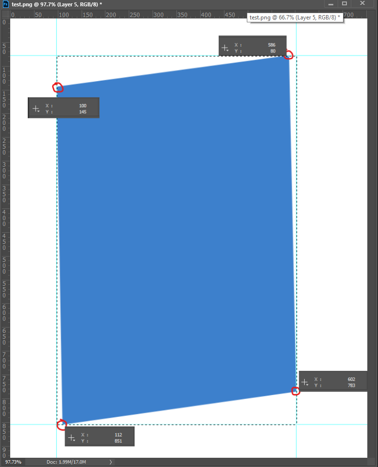

Nice of you to post a screenshot but please post a meaningful screenshot that includes the pertinent Panels.
Are you talking about a Shape Layer for example?

Please find the meaningful screenshot below.
I need to get the cornerpoints value from the selection.
if I use activeDocument.selection.bounds code, It is show as 0,100 for topLeft.
However I need to get the value (100,145) instead of (0,100) viceversa for all sides.
Could yoy please share your suggestion.Inputs?

You misunderstood – the screenshot fails to illustrate if the blue shape is a Shape Layer or something else.
Explorer ,
Nov 28, 2020 Nov 28, 2020
Hi c.pfaffenbichle,
It is a pixel layer not a Shape Layer.
