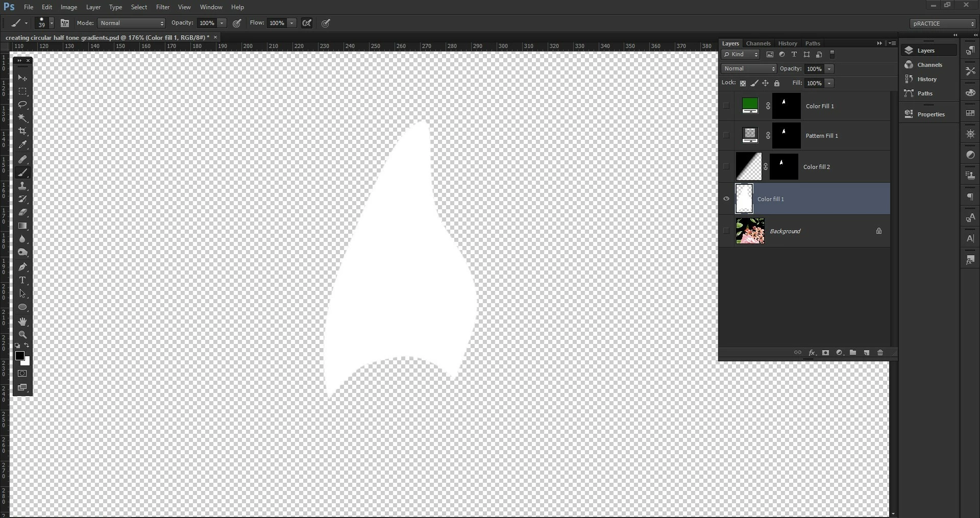

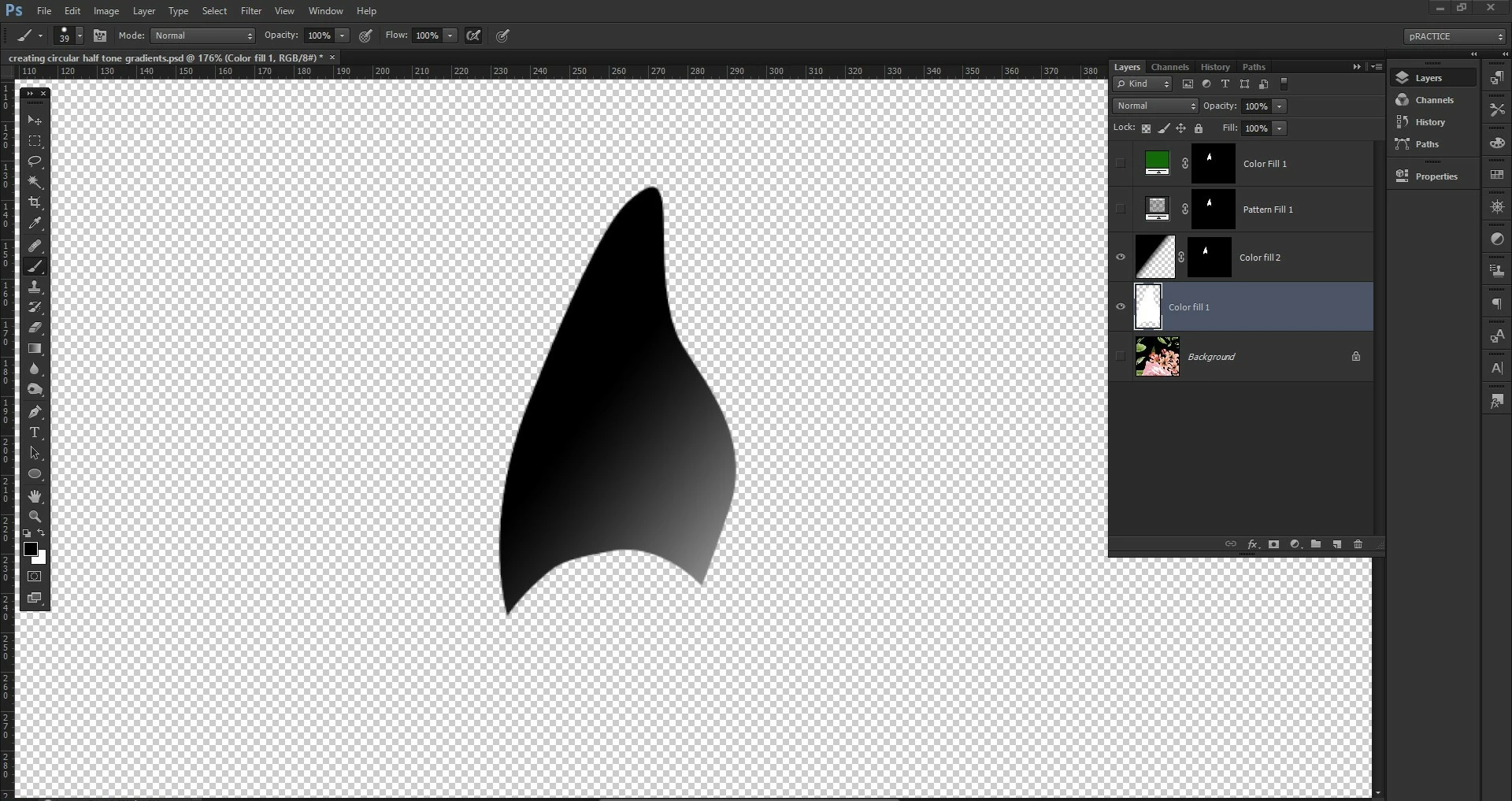

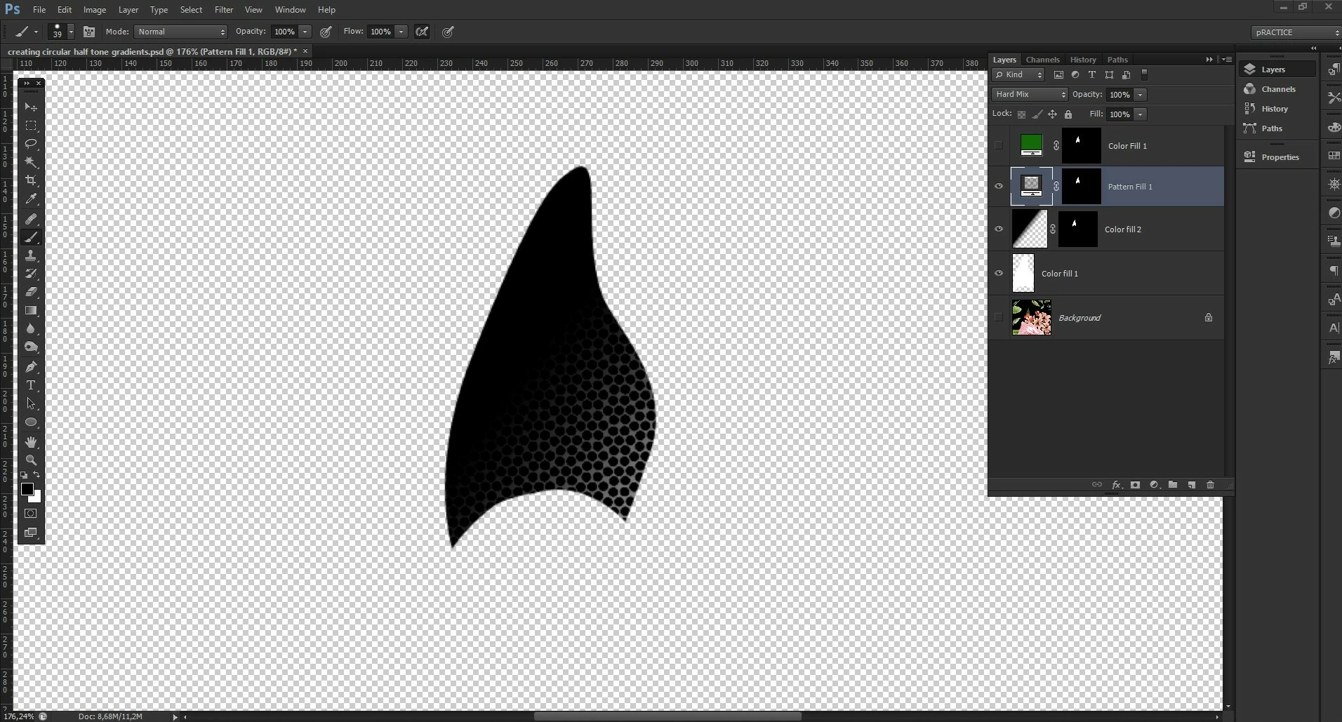

Good day sorry to bother you again but im still doing something wrong and just not getting it . I have attached what my layers looks like . if you could shed some light I would be greatfull. Thank you for you replies so far I know it must be irratating dealing with someone like this.

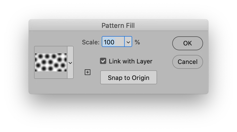

It looks like the Pattern has transparency – it should not, the blurred black dots should be set againts a solid white bacground.
And you should Clipping Mask those Layers together (Layer > Create Cliping Mask), then you don’t need a Layer for each one of them. Or puth them in one Group and apply the Layer Mask to the Group.

I need to create a halftone pattern of a painted area. I know how to make halftones I need it to look like the images attached. I have tried changing the angles but still can't get it .
as you will see the halftone pattern forms little circles/ moire's
