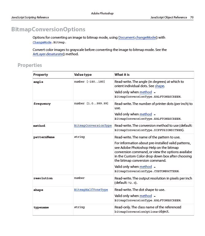

I was trying to convert a grayscale image to bitmap and can't move forward as couldn't find any documentation how to utilize BitmapConversionOption superclass.
This is what my script like.
#target photoshop
var doc = app.activeDocument;
doc.changeMode(ChangeMode.GRAYSCALE);
doc.changeMode(ChangeMode.BITMAP);
And from this point on I can't figure out to proceed with BtimapConversionOptions, to pass the parameters. Anyone can shed some light on this issue? It will be greatly appriciated

The bitmapConversionOptions are listed in the JavaScript Reference PDF for standard DOM coding. If the syntax is an issue, you could fast-track the process by recording AM code via the ScriptingListener plugin.
Edit - some searching came up with this DOM code:
var bitSaveOptions = new BitmapConversionOptions();
bitSaveOptions.method = BitmapConversionType.HALFTONESCREEN;
bitSaveOptions.angle = 45;
bitSaveOptions.frequency = 55;
bitSaveOptions.resolution = 300;
bitSaveOptions.shape = BitmapHa
bitSaveOptions.shape = BitmapHalfToneType.ROUND;
app.activeDocument.changeMode(ChangeMode.BITMAP,bitSaveOptions);

Thanks a lot, it solved my issue. I did read the documentation, but wasn't quire sure how to implement it.

Yes, it can be hard to get the syntax right without an example, which is why I suggested taking the easy way out and using AM code recorded via the ScriptingListener plugin:
var idconvertMode = stringIDToTypeID( "convertMode" );
    var desc180 = new ActionDescriptor();
    var idto = stringIDToTypeID( "to" );
        var desc181 = new ActionDescriptor();
        var idresolution = stringIDToTypeID( "resolution" );
        var iddensityUnit = stringIDToTypeID( "densityUnit" );
        desc181.putUnitDouble( idresolution, iddensityUnit, 300.000000 );
        var idmethod = stringIDToTypeID( "method" );
        var idhalftoneScreen = stringIDToTypeID( "halftoneScreen" );
        desc181.putEnumerated( idmethod, idmethod, idhalftoneScreen );
        var idfrequency = stringIDToTypeID( "frequency" );
        desc181.putUnitDouble( idfrequency, iddensityUnit, 55.000000 );
        var idangle = stringIDToTypeID( "angle" );
        var idangleUnit = stringIDToTypeID( "angleUnit" );
        desc181.putUnitDouble( idangle, idangleUnit, 45.000000 );
        var idshape = stringIDToTypeID( "shape" );
        var idround = stringIDToTypeID( "round" );
        desc181.putEnumerated( idshape, idshape, idround );
    var idbitmapMode = stringIDToTypeID( "bitmapMode" );
    desc180.putObject( idto, idbitmapMode, desc181 );
executeAction( idconvertMode, desc180, DialogModes.NO );
