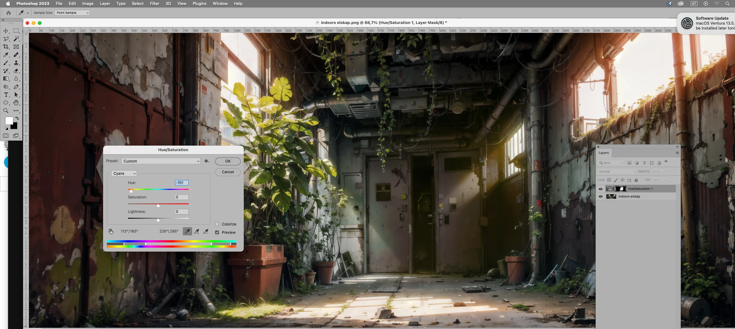

Adjustment Layers (like Hue/Saturation, Curves, Color Balance, …) with the appropriate Layer Masks could be helpful.
Bojan Živković11378569
September 11, 2023
You can use masks to change color temperature and brightness. Perhaps converting layer to Smart Object then opening in Filter > Camera Raw Filter can do the trick. Use Camera Raw masking option in combination with Temperature slider and lets say Highlights slider, at least start from there.
You can create multiple masks in Camera Raw filter.
