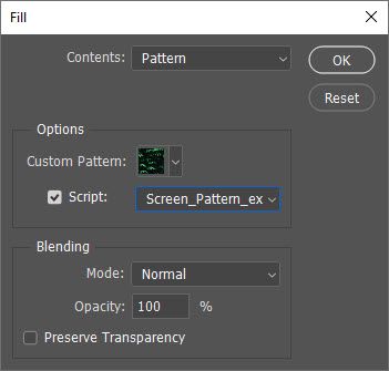

You could try the free Comic Kit plugin on Adobe Exchange (https://exchange.adobe.com/apps/cc/13159).
After you install it, do the following
1. Choose Edit > Fill
2. Choose Content: Pattern
3. Check the check box next to Script: under Options
4. Choose Screen_Pattern_ex from the script dropdown menu
5. Click OK
Then in the Screen Pattern dialog, select the following:
  1.  In the Basic tab, set Pattern Gradation to Radial
  2. Increase the Randomize Patterns amount as desired
  3. Modify the other settings as desired
  4. Click OK
You may need to test various settings to make the dots not overlap.

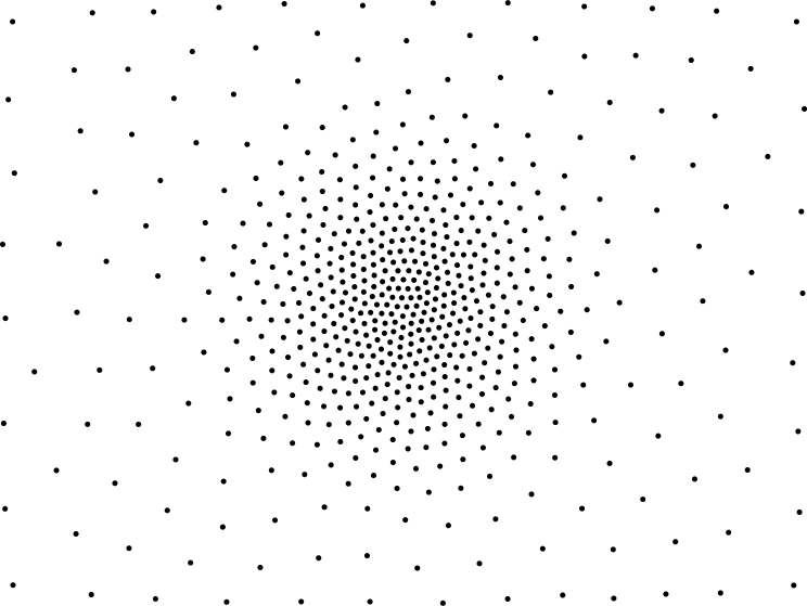

There is a program you can download called StippleGen, which generates points using Voronoi diagrams. If you run it on a radial gradient, you get something like so:
The result is saved as an SVG file. You can open it in Photoshop,but the paths for the individual points have a stroke but no fill, and can have little hollow white dots in their centers. If you open the file in a Vector editor like Illustrator, you can add fills and remove the strokes, and then copy and paste as a Shape into Photoshop (as I did here).
By @Semaphoric
Without access to vector tools, I'm sure that a hack such as duping the layer, applying the Minimum filter at the desired radius to expand and then the Maximum filter at a larger radius to contract smaller than the edges would work to fill in the centres.
I don't know SVG coding, however, it should also be possible to add the fill directly with a multiple find/replace.

Just tried these filters (new to me), and they work exactly as you described. Great tip, thanks.

Amazing—what a find! This worked like a charm the first time. Thank you!
