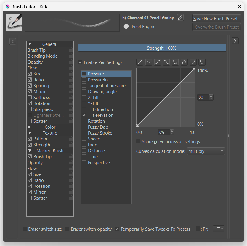

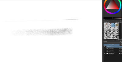

I've attached a screenshot within Krita with a default charcoal brush that works out of the box. I didn't change pen pressure, only the tilt of my brush.
If you have any advice on how we can achieve similar functionality within Photoshop, that would be greatly appreciated. Thank you.

I'd been playing with this for an hour or so before I asked about the charcoal_KA pencil brush, so well over two hours in total.  That includes watching the video you linked to of Ramon Miranda' amazing sketch of actress Jean Simmons using Krita.
image.pngA lot of that time was with the brush engine, which so far seems more complex than Photoshop's
So far I have not been able to create a Photoshop preset that comes close to Krita's CVharcoal_KA.  Presets that I thought might cut it suddenly leave me embarrassed to compare, and that includes several pencil sketch preset ideas I found on YouTube.

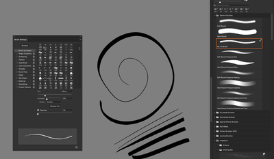

About the closest I have come is starting with this preset from the Dry Media group from the Default brushes.
As it comes it has no control of opacity, and looks like this regardless.

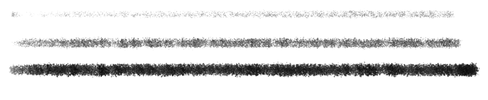

Changing size jitter to tilt has minimal effect with wither of my Wacom pens, but setting Flow Jitter to pen pressure got me to here.  It still doesn't feel as nice to use as the Krita Charcoal_KA preset though, and my gut tells me might never match it.
This is the Krita stroke.  It's opacity remains constant whereas all of the Photoshop pencil brush ideas I found have a regular dark/light/dark/light pattern.  The Krita stroke is definitely smoother. image.png

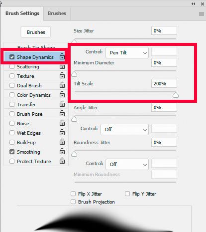

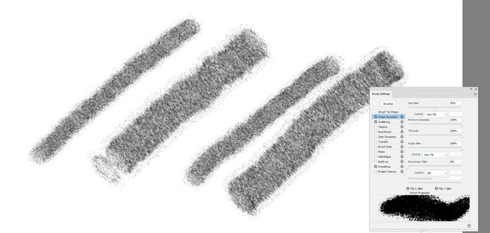

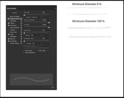

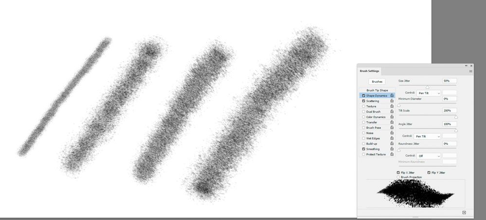

The effect of tilt can be lessened if you are using the dual brush function. Turning that off, setting the minimum diamater to 100% and tilt scale to 200% showed this difference in strokes between upright and tilted :
Photoshop is limited to 200% difference between upright and tilted (as set in tilt scale) but you can of course combine that with pressure by reducing minimim diamater to 0%. Left to right -  upright light pressure, upright hard pressure, tilted light pressure, tilted hard pressure:
If you need to use a dual brush, you may see less effect and you may also need adjust the size in the dual brush to work with the tilt.
It would of course be nice if we could go higher than 200% on tilt scale but we cannot at present.

@Trevor.Dennis here with the tilt scale at 200% the brush is wider when tilted and narrowest when vertical. You might be getting an effect from applying less pressure when tilted - turn the pressure minimum to 100% to check.
Dave
