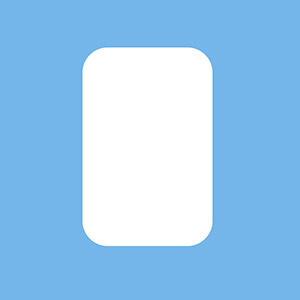

I have a white rectangular shape that looks a bit like a pillow, seen from above:
I'm trying to create volume, to give the pillow a round & symmetrical shape, with the lighting coming directly from above, so shading would be symmetrical.

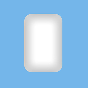

I tried just a Bevel & Emboss style and I got this:
But I think this adds too much grey. How can I create volume without adding to much grey on that white shape?

Starting with full white drastically restricts what you can do with shading.  Just a few degrees off full white would make life easier (250,250,250 for instance). If you use an inner shadow or bevel & emboss layer effect, don't forget you can control the opacity of the shading.  The eye can pick up on the slightest changes in tonal values, even if you don't have Eizo monitor 😉
What I did here was to stroke the outside of the shape with black, and blur it with a high value Gaussian blur (30 to 5
Adobe
May 11, 2017 May 11, 2017
What I did here was to stroke the outside of the shape with black, and blur it with a high value Gaussian blur (30 to 50) and clip it to the shape layer so you don't see the overspill.  I've reduced the layer opacity to 20% in this case, but you have complete control of the opacity.
Rather than make the inner shape white, a ring (layer 2) gives a better effect.
In fact I have taken the shape down to 245,245,245  and increased the outer shading layer opacity to 40%.  I have also cut off half the inner ring with a layer mask so you can clearly see the difference.

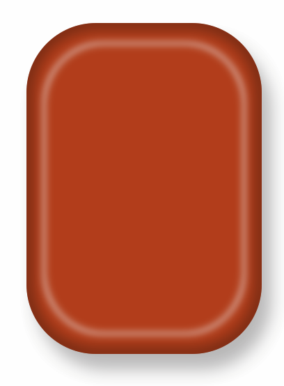

To use bright colours you need a different approach. Assuming the buttons are very shiny (reflective) they need harder shading.  The inner white shading used a stroke value of just 4 pixels and Gaussian blur 2.0.
I've also used a smaller outer shade with a stroke of 5 pixels, and Gaussian blue 10.  This time I Ctrl clicked the Shape layer to load it as a selection, and added a layer mask to the outer stroke layer
Increasing the blur value of the inner white highlight to 5 softens the highlight and makes the button look less shiny.
Incidentally, if you want to put anything on your buttons, the trick is to set the Fill value to zero which leaves just the effect like this.  The Bevel & Emboss direction is set to Down.
