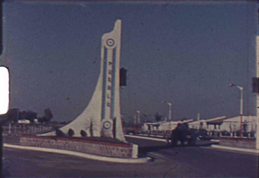

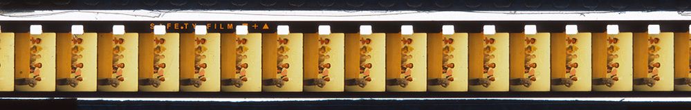

Apr 11, 2020 Apr 11, 2020
Hi Stephen, yes that is correct, sorry if i wasn't very clear or specific about what i need to do, this is the first time i'm doing this with super 8 film, furthermore, english is not my first language.
I will upload a sample of the image that the scanner made and one example of a frame of the film that i need to extract from each image strip in order to make a video.
I hard for me to believe the you have a single scan that contains 3000 super 8mm frames.   I would think  the you would have many scans of super 8mm film strips that contains some number of frames that have been straighten via a Photoshop.
I wrote a script to do that a while back for some user here. However, my script required the user to manually set two color sample points before running the script so it would be able to straighten a single strip. Extracting the frames contents was not addressed. could I use two magic wand selections to straighten an image
If a scanned strip is perfectly straightened you may be able to perfectly select all the frames content in the strip and crop. So all you will have is a image strip.  No borders no sprocket holes.  If you can do that you should be able to dice that image strip with an Action that uses a script I posted a while back
how to slice a very large poster.
You would still have to crop each film strip manually and run the action which has an interactive step where you set the guide line grid the number of rows and columns.  In your Image strip either a single row or column and some number of Frame.   If all your strips have the same number of frames.  You can rerecord the interactive step. Set the row or column to one and the other to the number of frames in the image strip.  Remove the check mark from the step dialog box. Then the action will be fully automatic

Apr 12, 2020 Apr 12, 2020
Did you try to dice a strip up  using the information in the link I posted? The action using a script...?
It look like it would work to me I just cropped your strip and set the guides
If all your film strips have 16 frames you can set your rectangle marquee tool to a fixed size for the 16 frames. make that selection and position it around the frame then crop. when you dice the up withe the action all frames will be the same size.
JJMack
So, you have multiple strips of 16 up frames?
The attached animation is the result of the script that I previously posted, using a column of 1 and rows of 16 as the input.
The image jumps around a lot as the total canvas size was not evenly divisible by 16.
Perhaps another method that used the sprocket hole to base the crop on would be better. Video is not my area, I keep thinking that there must be better, dedicated tools for this.

I have a question regarding 8mm Cine film frames.
I build a machine to photograph each frame from a Cine film, Standard 8mm (one with sprocket holes near the top left and bottom left corner) and Super 8mm (which has the sprocket hole in the centre on the left-hand side.
My problem is that in both cases, each frame is slightly out of alignment. I enclose examples of both and as you will notice, each frame is slightly up or down.
Although Standard 8 and Super 8 frames vary in size, the relative position to their own sprocket hole is the same.
Now I can manually "crop & save" each frame, but this would take a long time.
Would it be possible with the help of a script, to crop the frame, relative to the sprocket position?
I tried the script attached below, (thanks to ken Eckert (who raised the initial call), but this seems "crop & cut" in a fixed place.
