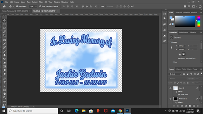

Feb 23, 2021 Feb 23, 2021
Hi Dave, I am working on a in memory of project and I have a couple layers. I am trying to use this method, but I can't get it to work. I used your exact settings from your screen shot above and I still have the square box. Do you have any idea what it is I am doing wrong, or how I fix it? I have attached a screen shot. The light blue box with the white clouds is what I am trying to do.
