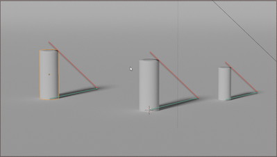

To add what Dave mentioned, if the main light/sun is coming from behind the subject, you can draw lines from different objects in the photo and extend them out. They should meet at one point. Then you can draw new lines from that point to your new object and get the proper angle.
May 13, 2022 May 13, 2022
Good point Chuck. The closer the light source gets to directly in front of, or directly behind, the viewer then the more the impact normal perspective has on the shadows. So, as you rightly point out, there is the vanishing point to take into account.
