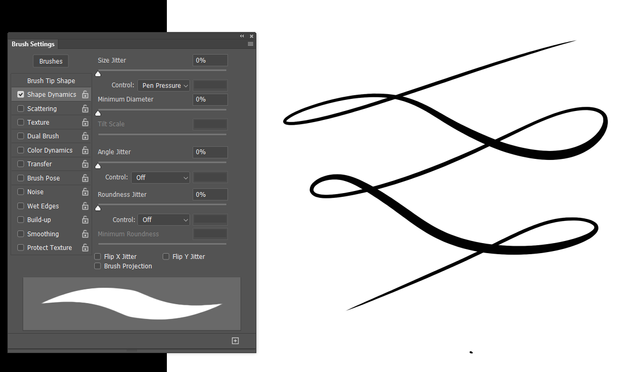

Community Expert , Nov 22, 2018 Nov 22, 2018
In the Brush Settings panel, under Shape Dynamics, set Pen Pressure to control Size Jitter. Then, from the Paths panel menu, select "Stroke Path...". In the dialog that pops up, select "Brush" for Tool, and check the "Simulate Pressure" box.
This setting is sticky, and will remain in effect until you turn it off by un-checking the box, so you can just use the Stroke Path icon in the Paths panel, or press Enter with the Brush tool active.

There's not a lot more you could add to that, as that is the way to do it.  Simulate Pressure is symmetrical, but if you stroke a path with a brush set to Fade, then it operates in the direction the path was constructed.  If you have a bunch of these to do, then the little Stroke icon at the bottom of the Paths panel is a godsend, but like  Semaphoric has  said, it will use the last used settings.
You can obviously adjust brush size and hardness on the fly.   This can be useful when you  are not sure about brush thickness.  Start  off thin and stroke the path, and keep increasing brush size  and clicking on the Stroke icon.  Then undo backwards if you go too far.

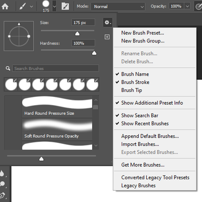

Don't listen to these guys. Just copy and paste what the last guy said...
Open your Brush setting from the ribbon up top. Left of the folder icon with a brush in it.
Click the down carat. Click the settings gear in the upper right corn of the drop-down look to the bottom of the list and see Legacy Brushes. In Legacy Brushes -> Default Brush 5 or 6 down is the brush you're looking for.

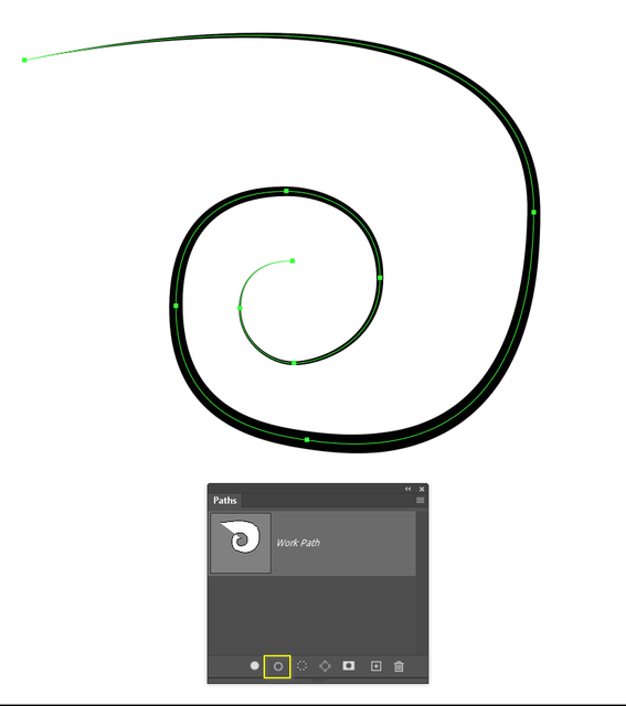

Use a hard round Pressure Affects Size preset, or create it in Brush Settings
Lay out a path with the Pen tool
Right click the Path and choose Stroke Path
In the pop-up dialog window make sure Simulate Pressure is checked.
And OK the stroke.  You need to set your brush up before this
Note: with this set up, you can create future strokes by clicking on the icon (my yellow highlight) at the bottom of the Paths panel.
