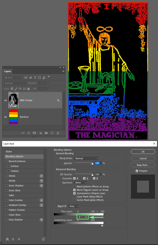

Hi Chris! Thank you for reaching out and offering to help - I really appreciate it! I've attached an image of what I'm going for. Really just want to fill in the white areas of the image with the rainbow image. I'm a total novice with photoshop so any advice would be great - thank you all again!
Sep 06, 2022 Sep 06, 2022
 @Clay25991967es2o
With a black and white image like that, Blend If is the way to go.
Arrange the layers as below.
You'll need to enlarge the rainbow graphic which you can do with Free Transform (Ctrl T)
Double click the B&W image to open the Layer Styles panel, and use the Blend If sliders moving them to the left.
Note you can get more control by holding down the Alt(Opt) key and seperating the slider.
Community Beginner ,
Sep 08, 2022 Sep 08, 2022
Thank you so much! I was able to do it!!

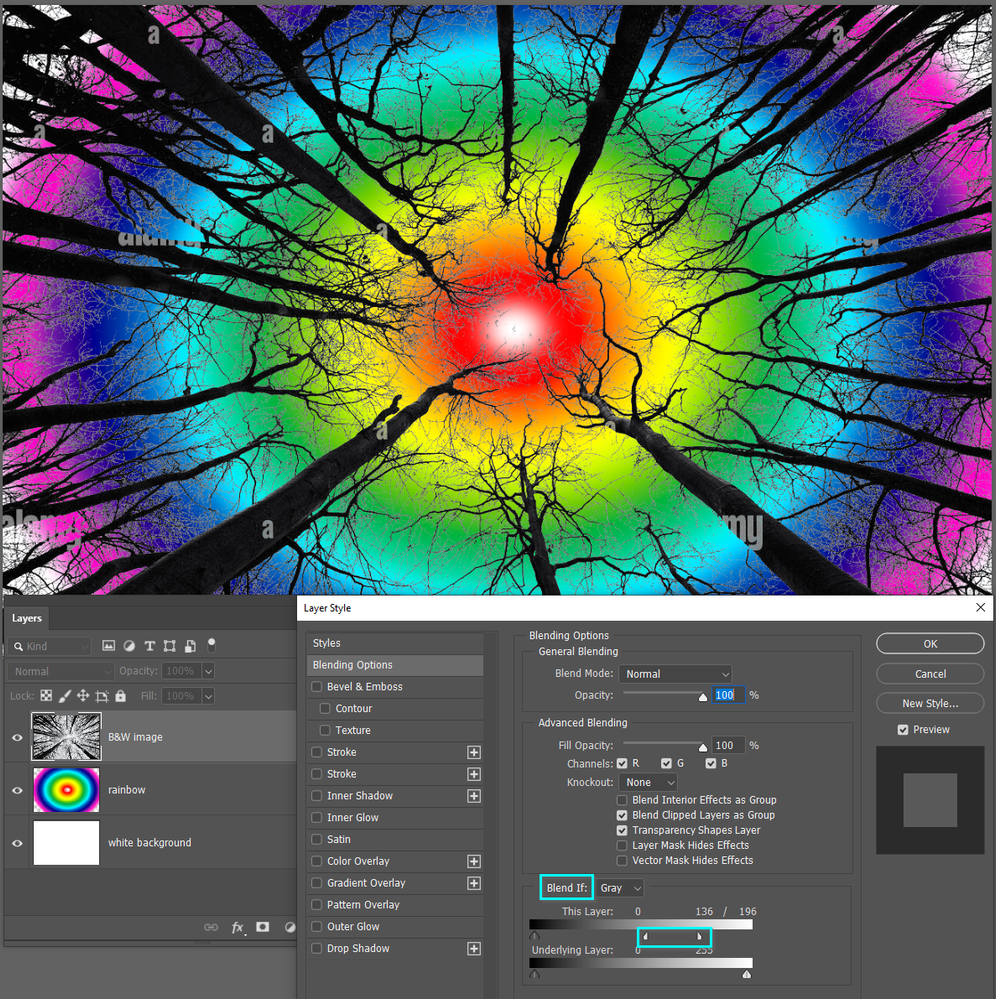

Another option, and perhaps a better one, is to place the rainbow layer above the B&W image and use Blend If
Double click the B&W layer to open the Layer Styles panel, and use the This Layer slider moving the right slider to the left.  If you hold down the Alt (Opt) key you can separate the right slider, as shown in my cyan highlight, to get more control over what tonal values will become transparent to reveal the rainbow in the layer beneath it.  You can see that this method has eliminated the slight fringe that shows in the layer mask version.
