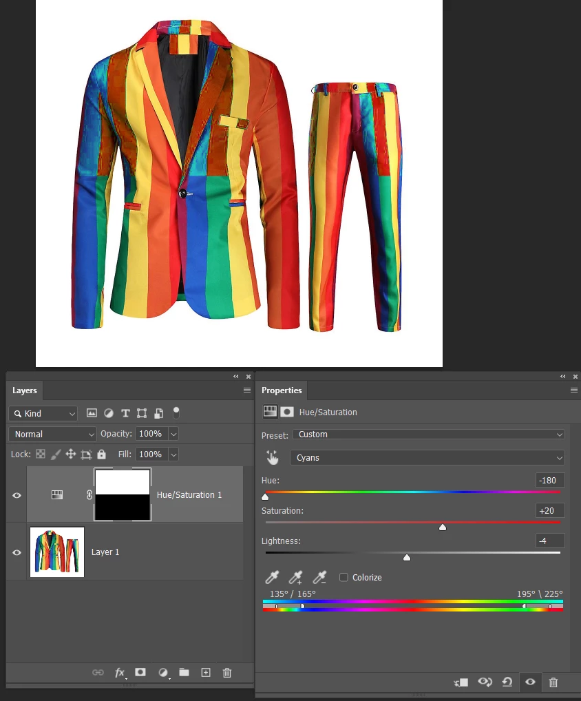

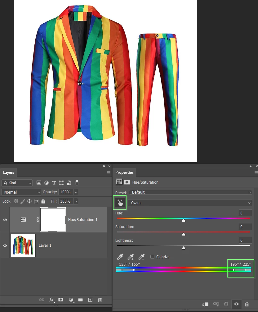

I'll use this as an example
Lets say we need to change the green.
Add a Hue/Saturation adjustment layer.
Click on the little hand icon, and then on the green color
You can see that that colour has been selected in the color bars at the base of the properties panel.
From here you desaturate and adjust the lightness slide, or adjust the Hue slider to change the colour
I have done the latter in the example below.
Note, that I have filled half the layert mask with black so we can see a before and after.
