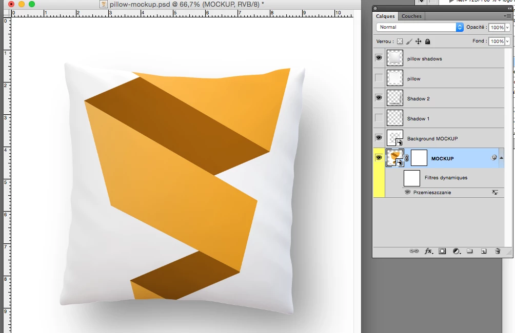

hi, fisrt, sorry for my english, I am french. I am going to try to be understood easily...
I have a mockup file (pillow-mockup.psd). As you can see on my picture white and yellow.  (Here is the mockup to download: Behance
I have to change the mockup using 1000 images (example : image1.jpeg, image2.jpeg) . As on my picture with pingoiuin.
I can do it but my final file has always the same name : pillowmockup instead image1, image2
What I did in my script
-I open pillow-mockup.psd on photoshop
-I open image.jpg on photoshop
- I move image1.jpg on the file mockup.psd
I would like to have my final file called image1 (or better : image1-mock) and not pillow-mockup
How to do  ?

It sounds like your doing the replacement  and because your replacing the smart object layer's object the filename of the replacement is lost in the shuffle.
If you were to automate the process with a script. The script would have access to that filename and could name the file it save and include that name.
I do not have a script that replaced smart object layer's objects because all replacement need to be the same size and resolution as the original template object. I prefer to be able to handle and size image.
I created a template from your template that would work with my batch script.  Because I do not use replace layer content I can not attach smart filter to image layers. I do place in images but would not know how to adjust a smart filter for the layer content. All my scripts can do is add layer styles to image layers.  However a demo of my script will show you the a script would have no prone creating the file mane you would want.
