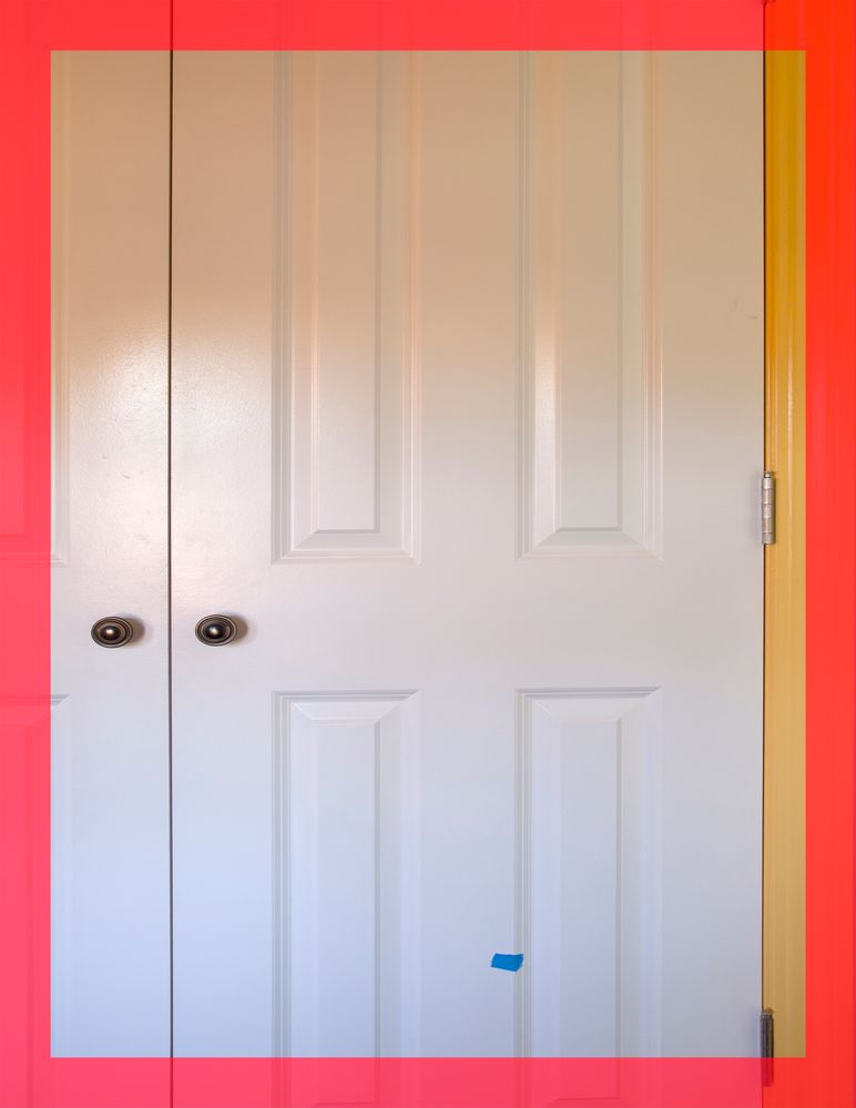

The first step I took was to try printing on my printer without using the 'borderless' paper setting so that it doesn't enlarge it.  Taking your suggestion, I created a custom-setting with paper size at 8.5x11"; and all margins set to 0.  But the print comes out with white borders on all four sides: 3 of them about 1/8" and the other one 3/32".  Because of that, the real image was shrunk on the print (I created a red border of thickness 1/2" as a gauge and they are printed thinner than 1/4", as you can see in the attached picture.)  Do you have a suggestion how to get around THAT problem?
With this problem, I assume that printing from Acrobat or Illustrator using automatic tiling won't work, right?
Community Beginner ,
May 14, 2022 May 14, 2022
Sorry I attached a wrong image.  Here is the right one with the white border.  IMG_3426.JPG
