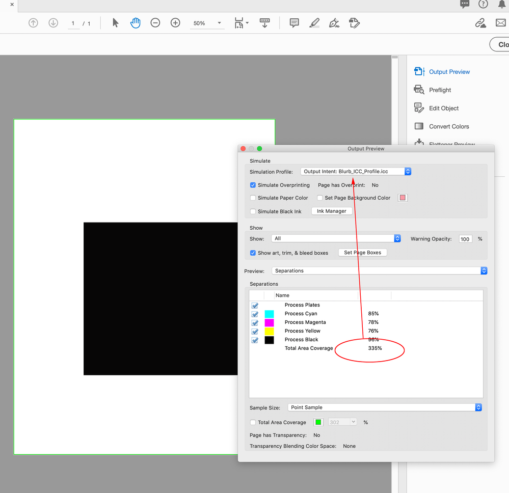

Here you can see my black Photoshop fill converted to 298% with the GRACoL2006_Coated1_GCR_bas profile as the Destination, which is assigned to the document on the conversion:
If I export my InDesign example to the default PDF/X-3, Object Inspector tells me the image has GRACoL2006_Coated1_GCR_bas embedded, but the Output Intent is Blurb_ICC_Profile.
If the output is to the Blurb Output Intent profile the black converts back to 335%—a bit under the Blurb_ICC_Profile’s ink limit:
The only way to maintain the 298% output values in the PDF would be to save the image with no profile, or set InDesign‘s CMYK Policy to Preserve Numbers (Ignore Linked Profiles).
