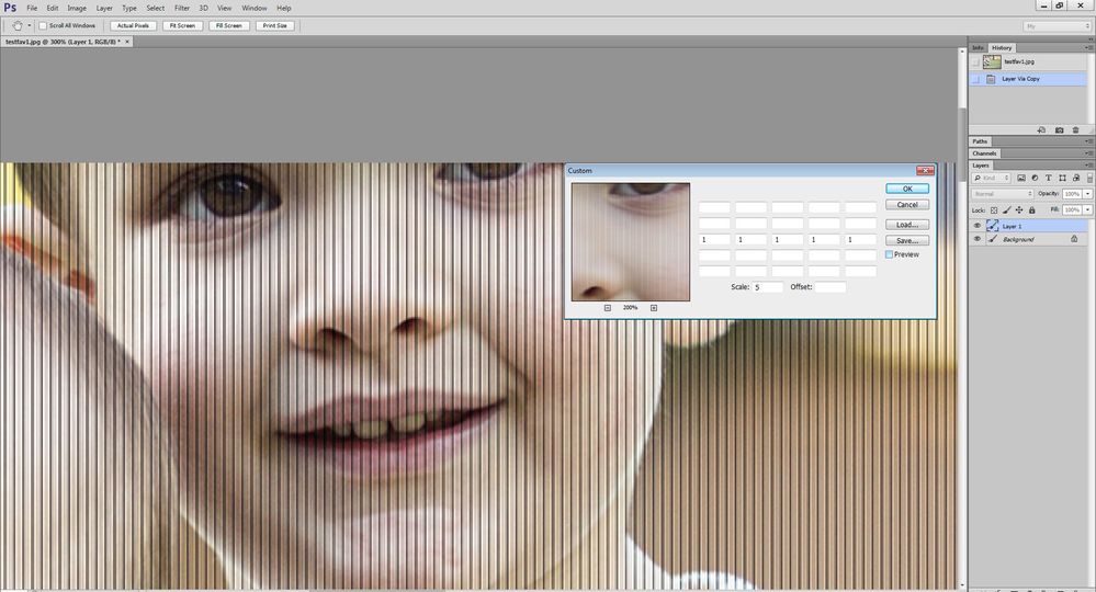

I think my Canon EOS 5DMarkIII has a readout circuit that has gone bad that is causing every 8th pixel to be RAW causing these black lines all over my photo.  Does anyone know if there is a way to fix this in photoshop? See attached photo.

Apply this filter two times.
The screenshot shows the result of the first application.

Can you be more specific about about you did that?
LEGEND ,
Oct 24, 2021 Oct 24, 2021
Open the image you attached, then use the Custom Filter. Finally see the correction effect.

Never mind I figured it out.  That helps so much thank you!

Help menu, type in:
Custom
Nov 10, 2023 Nov 10, 2023
Filter > Other > Custom

Great to see the Custom filter still being used, it doesn't get much attention these days!
@Chelsea5F84
You'll probably want to add some Smart Sharpen or similar to try to restore some of the clarity to the image from the softening introduced by running the custom filter.
