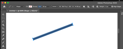

After drawing a line with the line tool, changing the stroke thickeness doesn't do anything.
Infact it looks like a box shape was drawn instead of just a line.
Has this always been the case? or is this a bug.
I"m on version 21.2.0

What setting are set: Path|Shape|Pixels, weight ,start, end, etc? A line is a box

So it seems the stroke width is 'clipped' inside the weight.
Has it always been like this? Surely I would've complained about this a decade ago. it makes no sense....

How well a stroke renders depends a lot on size, resolution and magnification.
The second shape is six times the size  of the first shape at 1/6 the magnification of the first shape

A line 1 pixels wide(weight) is still a rectangle width  line length height 1 px.  What is the size of a pixels that is the print dpi resolution.  Is it 1/300 inch 1/100 inch. If a line has more than 1  px weight is a larger rectangle it height id more then one pixel. If a line shape is filled the fill will be contained to the shape's path. However the  a Shape path can be stroked with a line stroke on the  line path outside the path inside the path and the stroke line can have weight itself.  If you stroke a line that has a 1px weight  with stroke with a 10px weight how big is the overall rectangle.  That would depend on the stroke was  it on the path, inside the path  or outside the line's path. There can the three possible sizes. Corners can differ depending on how the stroke is applied.
Line is Blue, Stroke is Red, Stroke is outside the line's path the line has square corners the stroke does not because is an outside stroke and the option is not square.  An inside stroke would have square ones. and the stroke would cover the blue line.
