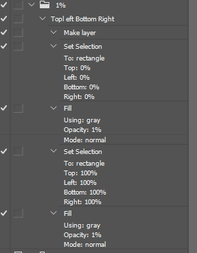

One of the thing the Photoshop does to you layers is to trim the layers bounds to the layer pixels area bounds. In other words full Transparent boarders are trimmed off. So your layers have different sizes and aspect ratios they are not canvas size. This can be a problem when you want to animate things that require the boarders to be present or layers to be the same size. The way I would address your issue would be to modify you png files with a batch action. What my action does is to add a layers the has two basically invisible pixels. A 1% opacity gray pixel in the top left and bottom right canvas corners. Save PNG file will not have fully transparent boarders they will just look like they do. You layers stack layers will all be canvas size.
