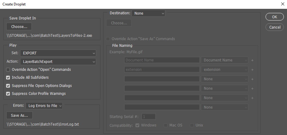

Thanks for the suggestion, I actually tried this one before. It has two issues for me though - I wonder if it's bugged or if I'm doing something wrong.
1. In the resulting PNG files, which all end up in the same folder, you can see that all of them have the same prefix. It takes the name of the first PSD and applies it to all following files for some reason. Thankfully, the layers are numbered correctly, but the only way to tell which PSD they belong to is to go by the date or to manually check them.
2. I renamed my 3 test PSDs after the first try, recreated the droplet, restarted PS and my PC, but for some reason the old prefix "com1-age-baby_" stays the same. It shouldn't be there anymore, the PSD name doesn't exist anymore and I have no idea why it would do this.
This is how the layers came out. The prefixes are wrong, but the layer names are fine.
This is the PSDs I was using. One of them was previously named "com1-age-baby_", resulting in the export prefixes.
These are my recorded action and my droplet settings.
I'll try to work around it but it would be cool if there was a fix?

Setting up a script and batch action are not always easy teasks… But it is worth the pain.
I think that you should check the File Naming where you can specify exactly how you want the result files be named.
Check the box to override the script instructions and you can use all sort of  prefixes and suffixes.
Just use a line for any of the one you want.
Hope this will help!
