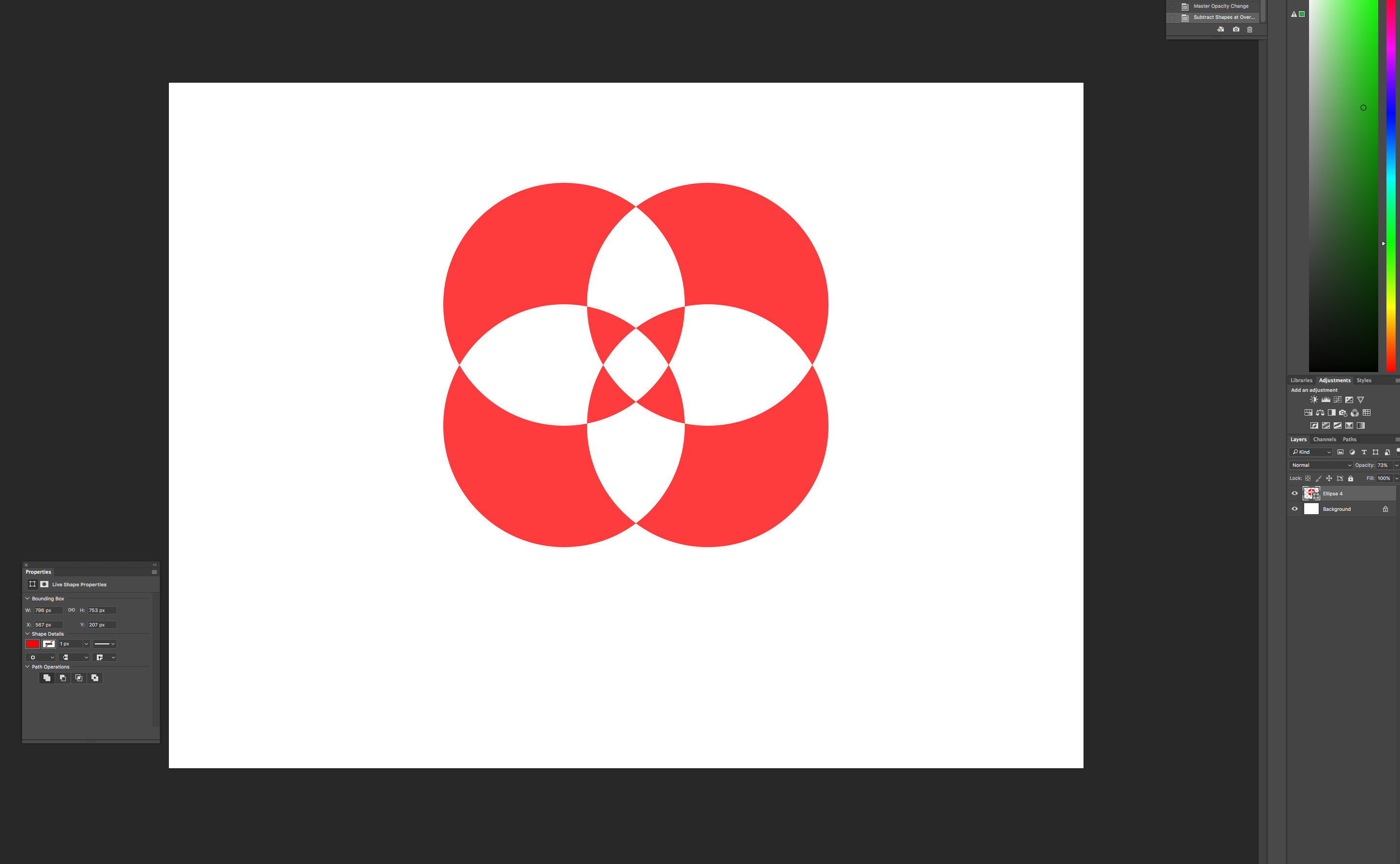

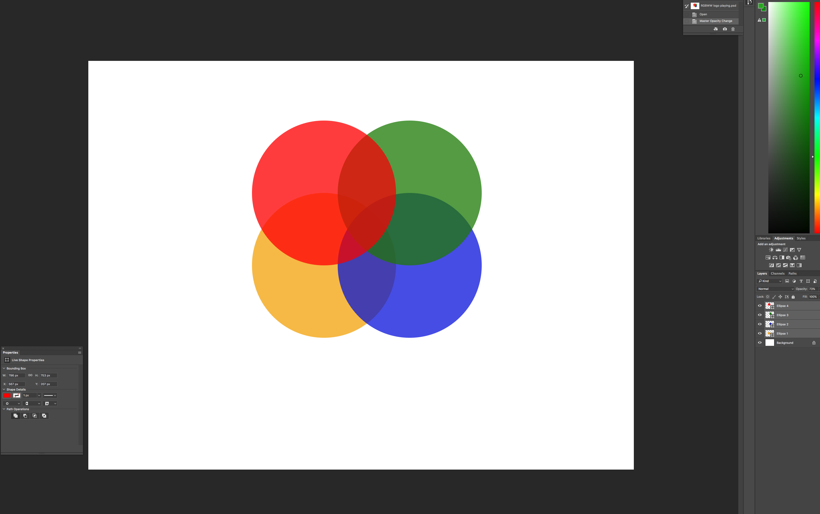

Sep 06, 2017 Sep 06, 2017

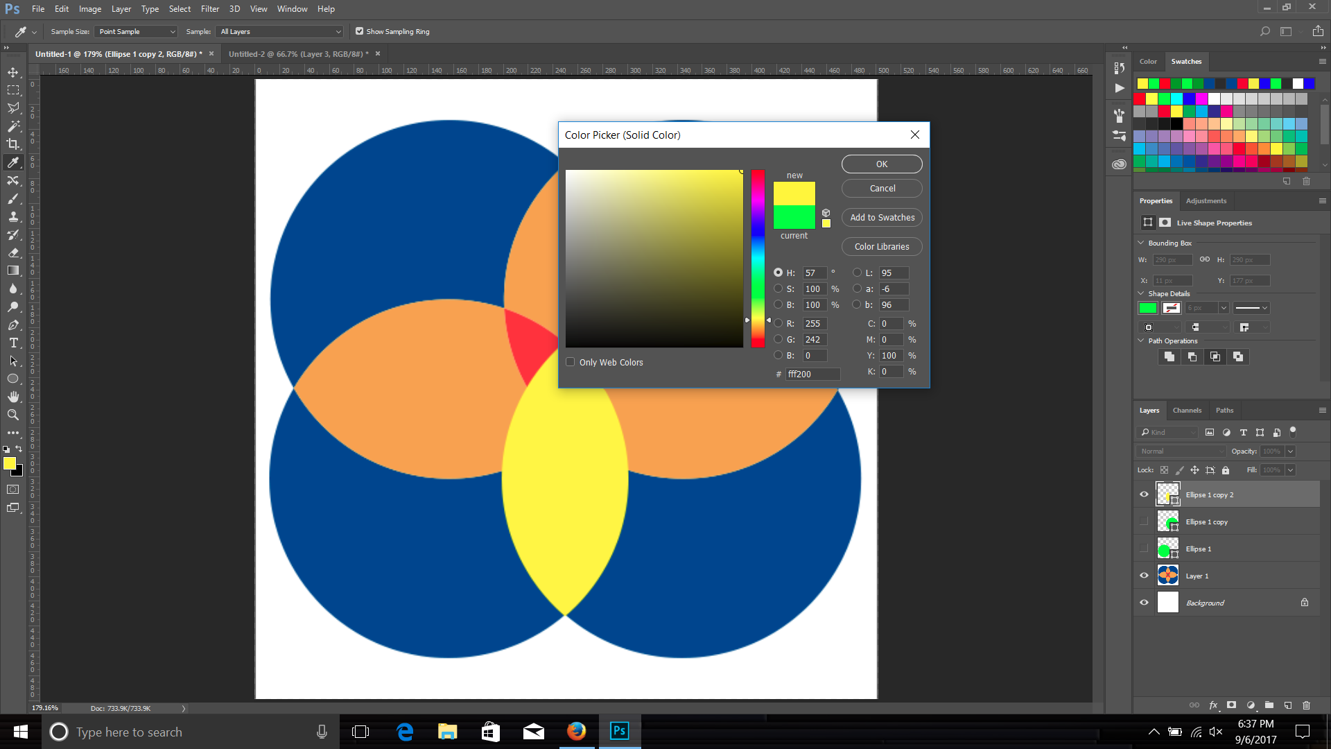

Can you post a screen shot of your file, showing the layer panel? I think the best way in your case is to have separate layers with solid color shapes that you can change the color by using the swatches.
New Here ,
Screen Shot 2017-09-07 at 11.33.39 am.pnghere you go

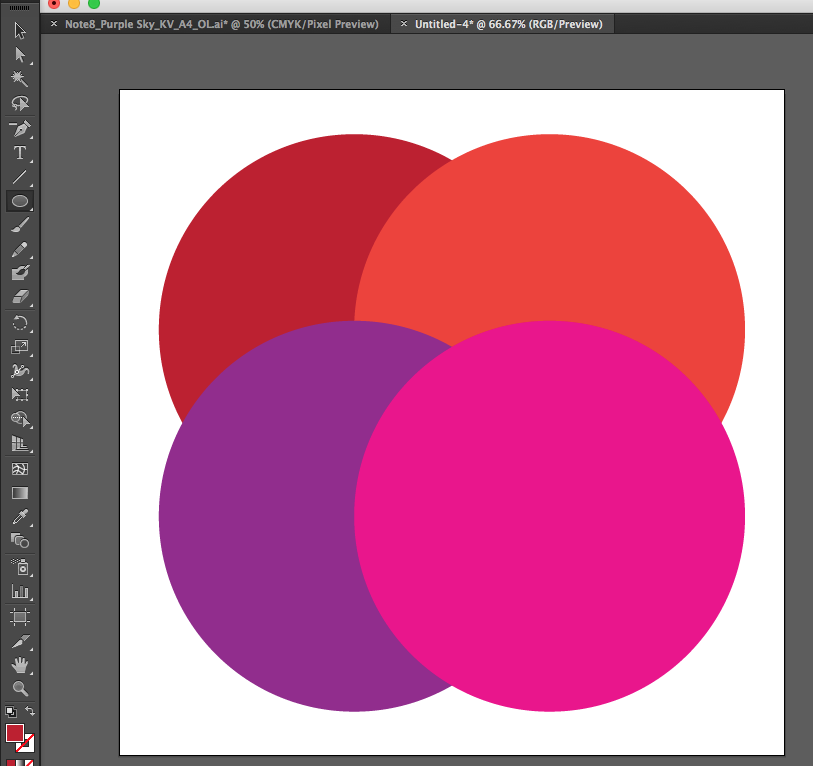

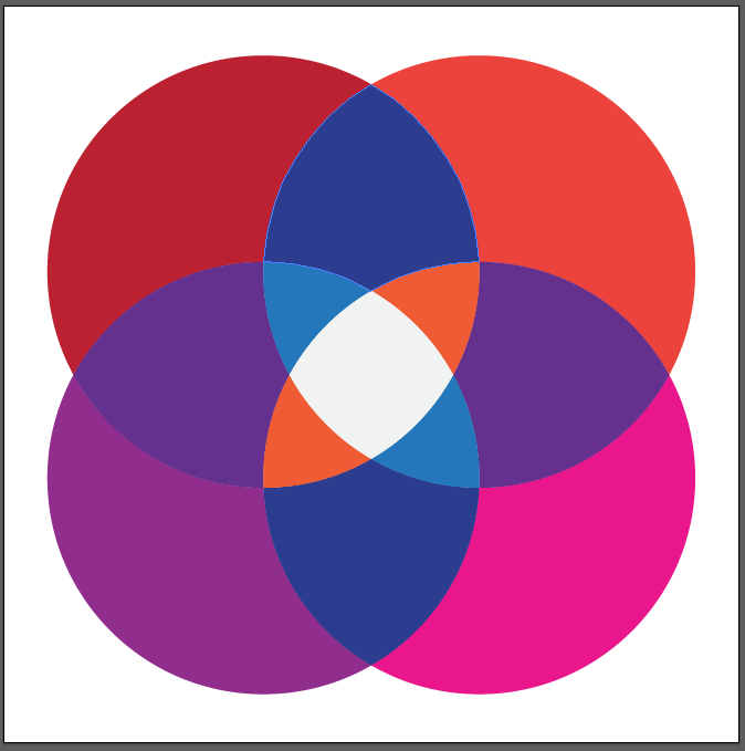

Here is how to do it in illustrator
1- Open a new file in Illustrator
2- Click on Ellipse tool
3- Draw four circles and color them

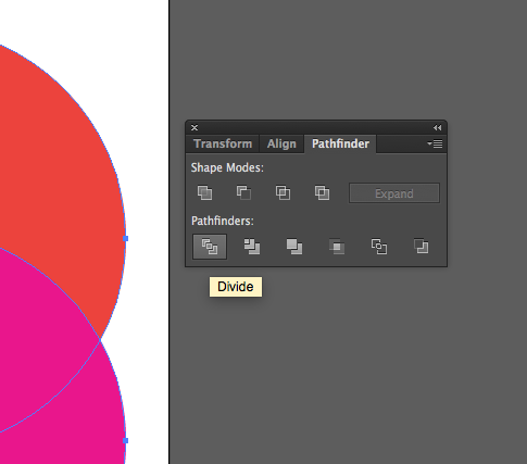

4- Select all of the circles and then select Window>Pathfinder and click on the Divide.

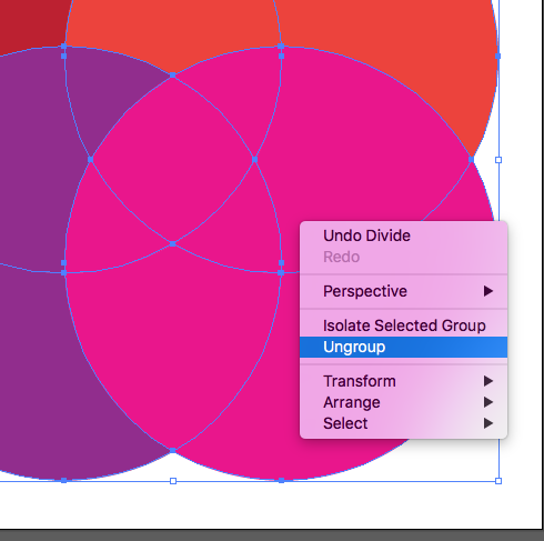

5- Right click on the shapes and ungroup.
6- Select any shape you want and color it
Hope it will help you
Ahmed

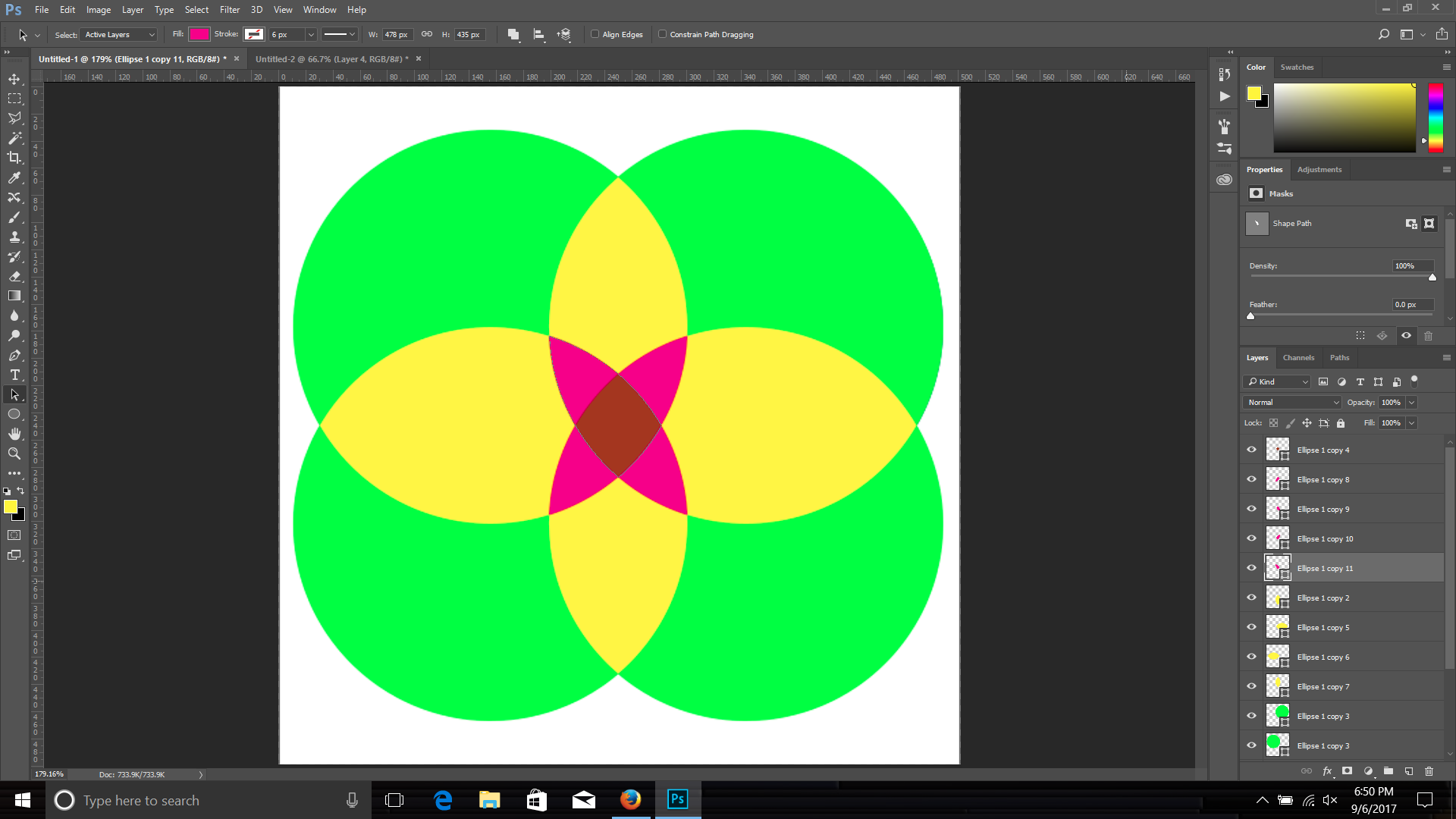

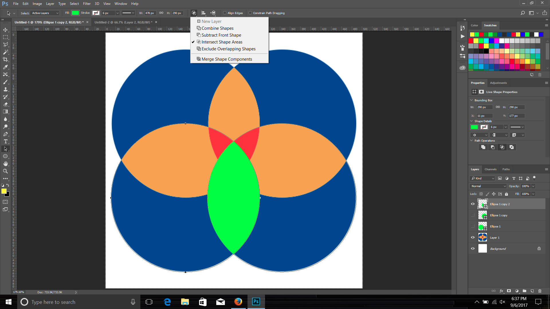

Ok, you you have shape layers, which is even better. You can duplicate those shape layers, select the path from on of the overlapping shapes and paste it into the duplicate shape layer. You can then use the Intersect shape areas, then combine shape areas to make new layers for each of the shapes.
In the end you will have a shape layer for each shape that you can change the color by double clicking on the icon in the layers panel.
