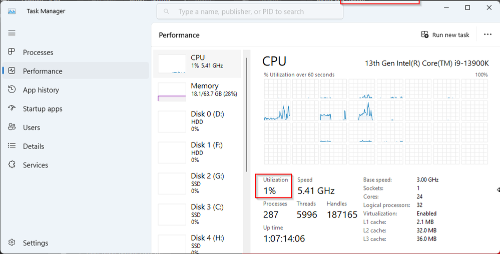

Hi Sandra
Open the Task manager (Ctrl Alt delete) and click on the Performance tab.
Click on CPU if not already selected, and look at the Utilization while using Photoshop.
The window will remain on top.
Your CPU speed is on the low side, so might be getting maxed out.
How big is the file you are working on? How many layers etc.?
Look in the root of your Primary Scratch disk for Photoshop Temp files, and see what size it/thay are? BTW If you have multiple temp files, they should all have today's date. Any left after closing Photoshop can safely be deleted.
I think it is likely that with 8Gb RAM you'll have a large temp file, which will mean lots of disk activity. That will also cause heat to build up.
Is this causing an issue? How hot is the CPU getting? If your system does not display temp, apps like Core Temp and Speccy should do that for you. Be careful if you install Core Temp. Some of those invite you to install other apps like AV. Make sure you decline if you see that.
If your system is getting hot, then it probably has a fan speed control in the BIOS or an installed motherboard app. Google should help you with that, but tell us what you are using and we'll look it up for you if it helps.
Is this a laptop? Is it being used on a hard surface so that cooling vents are clear?
Are the vents clear of dust etc.
