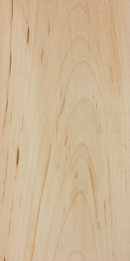

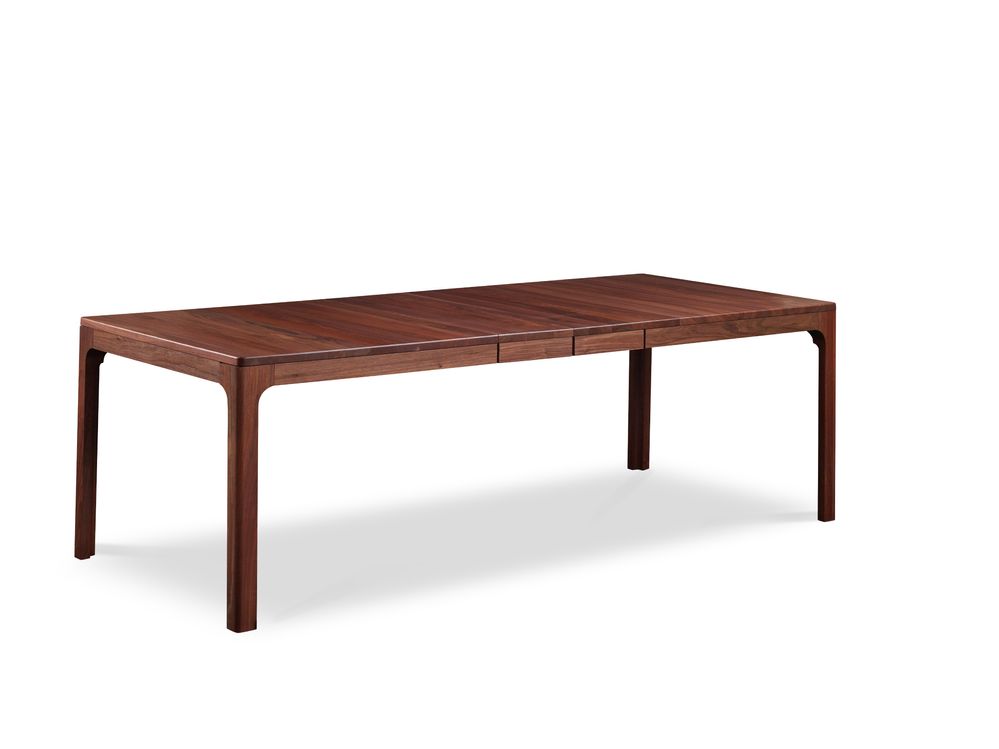

Awesome, thank you! Here is an example of the first one I am trying. I need to get the table to be shown in the maple (lighter) wood. I will look up a tutorial and hopefully that works! Thanks again!

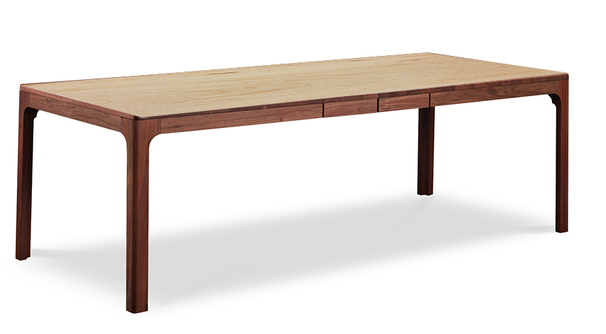

You can make a selection of the table top and use the Transform commands (Scale, Rotate, Skew and Distort) to get the table top transformed into the same shape as the top of the table. and then use the Adjustment Controls (Levels, Curves) to match the color of the existing table.
Here is an example:

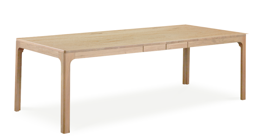

I used Transform to add the flat wood grain tot he top of the table — Rotate, then Distort and then Scale). Then as you can see in the other image I used an Adjustment Layer with Levels to change the color of the table legs. Besides using an overall adjustment, I added a little bit of yellow in the Blue Levels slider.

Thank you so much--that's really helpful. I tried with layers and masks and got somewhere, but what I am finding is that the images just look like silouhettes with different wood. You lose all of the details of the piece (see my example image). So I am really interested in your method, that looks SO GOOD!
Could you give me a bit more info about how you used "transform" to get the table top like that? I totally get the adjustments and will be able to do that on my own, but I'm not sure how you got the maple grain on the tabletop.

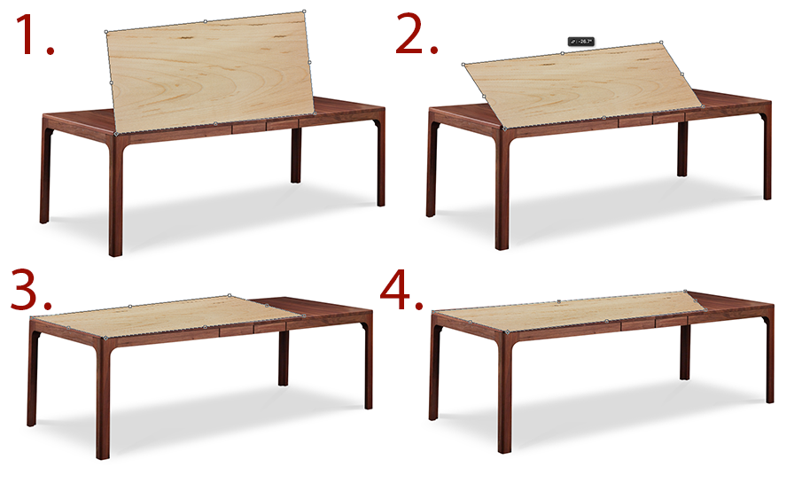

1. The first step, after bringing the image into the file, is to rotate the image to line up the long side of the flat wood grain with the long side of the table--those two edges should have the same angle. Transform>Rotate. Do not hit enter--make sure you still have the active handles around the outside of your table topl
2. Then choose Transform>Distort and grab the middle handle on the long edge and move it down so that the top left corner of the wood meets the top left corner of the table. (Again, don't hit ok)
3. Grab the top right corner handle and move it until it touches the top right corner of the table. Then grab the bottom right handle and move it until it reaches the bottom right corner of the table. Now make any adjustments if you need to meet or fix any edges and hit ok.
See the images below:
Have fun! Let us know if you have any questions.
