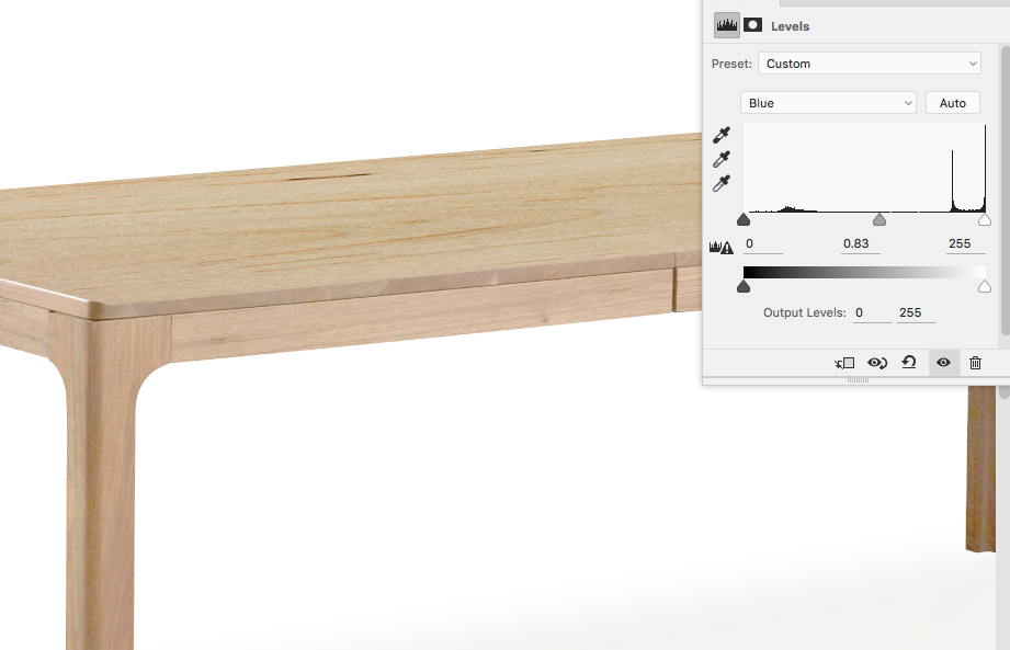

You can make a selection of the table top and use the Transform commands (Scale, Rotate, Skew and Distort) to get the table top transformed into the same shape as the top of the table. and then use the Adjustment Controls (Levels, Curves) to match the color of the existing table.
Here is an example:
Screen Shot 2020-07-29 at 10.43.31 AM.pngScreen Shot 2020-07-29 at 10.43.08 AM.png
I used Transform to add the flat wood grain tot he top of the table — Rotate, then Distort and then Scale). Then as you can see in the other image I used an Adjustment Layer with Levels to change the color of the table legs. Besides using an overall adjustment, I added a little bit of yellow in the Blue Levels slider.
Let us know if you have any questions.
