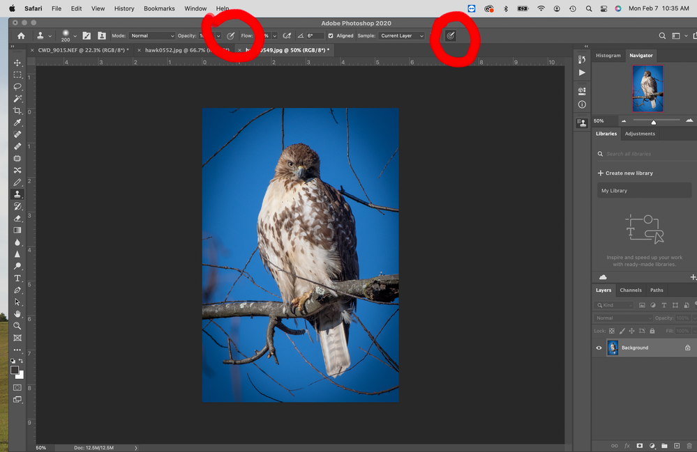

New Here ,
Feb 07, 2022 Feb 07, 2022
I had the same problem on my Mac M1 with PS 21.2.12  I solved it by clicking on these:
