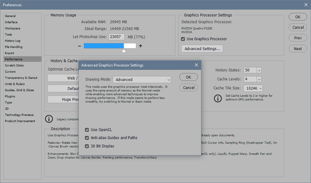

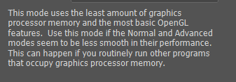

Performance > Advanced Settings > Drawing Mode - Restricted to Basic in Photoshop 22.3 on Windows 10
Apr 01, 2021 Apr 01, 2021
This started with Alt Right Click brush size not working, and a look at Properties > Performance > GPU Acceleration > Drawing Mode showed it was set to Basic, and the other options were greyed out.  I thought that Alt right click brush size should still work with Drawing Mode set to Basic, and restarting the computer did get that working, but Drawing Mode was still restricted to Basic.
I upgraded the video card driver (RTX2070 — 465.91
I checked Windows 10 for updates and restarted the computer a couple of times.
This post on the Feedback site (December last year) shows a similar issue with V22.1 on a MBP but there are too many differences to consider it highly relevant.  The thing is I have not checked GPU Drawing Mode for a good wee while ass everything was working.
I've been keeping up with the forum for a few weeks now and have not noticed similar threads, and while I am not losing sleep over this, it does say:
...so does anyone have any thoughts?

I have no idea why, but I am suddenable to set Drawing Mode > Advanced to Advanced.  All three options are now available.
[EDIT]  Well it worked for about two minutes but has reverted to Basic again.
Apr 07, 2021 Apr 07, 2021
Yes - I also had that happen. In the end I reverted back to 22.2 which works reliably

Yes I see the same things. If you fiddle with the settings turn off GPU restart Photoshop you may be back on and set Advance mode and the restart Photoshop and it may or may bot still be set to Advance but eventually in will be set to basic.  You may also see in your Photoshop System Info the Photoshop had crashed on some date that Sniffer crash in Photoshop but it will run without issue from a command line and that Drawing mode is still Advance Mode but is allowed is false. Will sett if 22.3.1 changes anything.
Native GPU: Disabled.
Manta Canvas: Enabled.

Apr 13, 2021 Apr 13, 2021
I just installed 22.3.1. Removed all  PS 22 user Application  Data.  My Plug-ins, scripts  and add on noy atted to use rApplication data will still be installed because the were add to Photoshop Install Tree by mes.  When I started  PS 2021 I see the Photoshop's Preference Performance GPU Advance Setting Dialog has been changed again and I can select Advance drawing mode So I did and the closed down Photoshop.
When I restarted Photoshop the settings were still set.  I then looked at System Info a lot of things changed there. While I still saw a WintTabs section.  The was no PSUserConfig info.  I see a Photoshop Crashed on and sniffer crashes today it also look like sniffer worked this photoshop startup all the sniffer Info seem to be present and the dreawing Advamve alloded False is not in there].

glgpu[0].GLFrameBufferOK=1
glgpu[0].GLIsPreferred=1
NumCLGPUs=1
clgpu[0].CLPlatformVersion="OpenCL 1.2 CUDA"
clgpu[0].CLDeviceVersion="1.2"
clgpu[0].IsIntegratedCLGPU=0
clgpu[0].CLMemoryMB= 4,294
clgpu[0].CLName="Quadro K2200"
clgpu[0].CLVendor="NVIDIA"
clgpu[0].CUDASupported=0
clgpu[0].CLIsPreferred=1
clgpu[0].CLBandwidth=6.200000e+10
clgpu[0].CLCompute=392.201774
clgpu[0].CLRawDeviceName=Quadro K2200
clgpu[0].CLRawDeviceVendor=NVIDIA Corporation
clgpu[0].CLRawPlatformName=NVIDIA CUDA
clgpu[0].CLRawPlatformVendor=NVIDIA Corporation
NumNativeGPUs=1
nativegpu[0].NativeName="NVIDIA Quadro K2200"
nativegpu[0].NativeGPUAccessibleRAMInMB= 4,250
nativegpu[0].NativeVRAMInMB= 4,250
nativegpu[0].NativeDedicatedSystemRAMInMB= 0
nativegpu[0].NativeSharedSystemRAMInMB= 21,435
nativegpu[0].NativeVendor="NVIDIA"
nativegpu[0].NativeDriver="C:\WINDOWS\System32\DriverStore\FileRepository\nv_dispwi.inf_amd64_ee38507845c910a2\nvldumdx.dll,C:\WINDOWS\System32\DriverStore\FileRepository\nv_dispwi.inf_amd64_ee38507845c910a2\nvldumdx.dll,C:\WINDOWS\System32\DriverStore\FileRepository\nv_dispwi.inf_amd64_ee38507845c910a2\nvldumdx.dll,C:\WINDOWS\System32\DriverStore\FileRepository\nv_dispwi.inf_amd64_ee38507845c910a2\nvldumdx.dll"
nativegpu[0].NativeDriverVersion="27.21.14.6172"
nativegpu[0].NativeDriverDate="20210223000000.000000-000"
nativegpu[0].NativePowerEnvelope="UNKNOWN"
nativegpu[0].NativeDeviceAttachment="UNKNOWN"
nativegpu[0].NativeAPIVersion="12.0 (12.0)"
nativegpu[0].NativeIsPreferred=1
snifferEnd="2021-04-13_09:01:11"
------- GPU
JJMack
