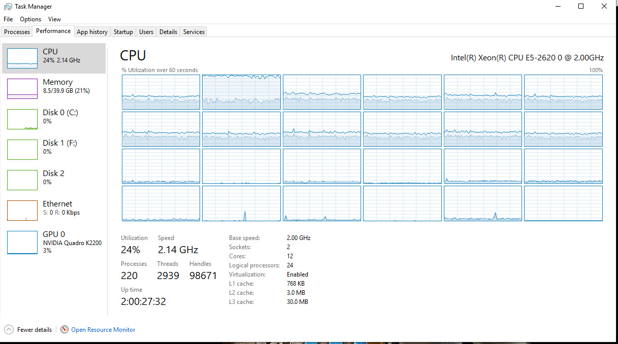

Community Expert , May 18, 2019 May 18, 2019
Your screen capture of the task is not showing anything you can say as far a brush stroking goes.  You single Processor  has 6 cores and most likely can run 12 Threads.  You are not showing the load for each  thread.  You also need to not continually stroking with a brush so all your are seeing in the plot is basically your machine doing brush strokes all processor should more or less have  const level of utilization.
If you look at my machine it has two slow 6 core processor.  24 threads can  run concurrent. However,  It look like Photoshop is only using 12 Threads to do the brush stroking  only 12 thread seem to have as consistent load on them. And one is maxed out its has no more power. The sequential nature of a brush strokes means if you multi task it you need to sync all the task so  the stroke is laid down in order. If one task can not keep up with all the others it will slow all the other task.  It take a lot processing to render a brush stroke.   It takes time to process a pixel.  If you are  Processing millions of them it is likely you will not be able do the calculations required in near  real time.  Brush stroke will always lag some they need to be calculated and rendered. After  you start the stroke and will finish shortly after you finish your stroke if your machine is up to the task. If the amount of data is small you may not even notice the lag. The more you complicate the brush  size, sample tip  blending, smoothing etc increase the computations that  need be performed.  It is easy to produce unacceptable lag. I did so many quick large brush strokes on a large canvas zoomed out it most likely took minuets for Photoshop to catch up after I stopped brushing.

Community Beginner ,
Thank you, CPU 1 has been maxing out. My apologies for my confusion.
If this is the case, would it be possible to increase the threads Photoshop allocates for the brushstrokes? Or use the threads more equally, seeing as I only seem to have 12? I don't use it for much else other than painting, but I'd also prefer to not bug it up.
