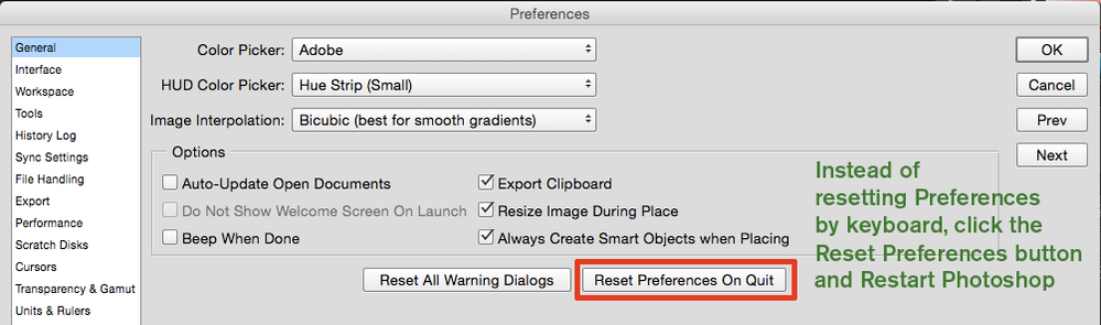

Likely corrupted Preferences. Please try a reset as shown below:

That did the trick! Thank you!

Yes, this worked on restoring my missing canvas with Standard Screen Mode (using Pshop 22.0.1 - new for 2021 on Mojave)

This solved the problem for a day. Today it started to glitch again - choosing any other screen mode resets to Standard Screen Mode immediately. Is there a long term solution to stop the preferences from getting corrupted? I like to have a lot of custom shortcuts and stuff : /

Maybe save your workspace, then reset preferences, relaunch Photoshop and load workspace.
