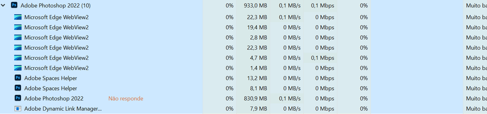

Hello there, just bought the Photoshop 2022 a few days ago.  On windows 10, the program freezes constantly whatever I do.  I do have to shut down Photoshop with the task manager.  As I read every thing here about this, is there any solutions to date?

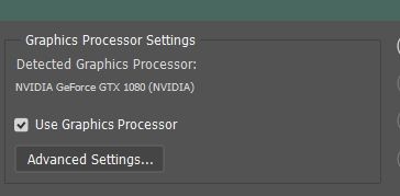

@Ken Curtis were you able to test the suggestion to disable the native canvas in preferences/Technology Preview? This is know to cure many issues.
Also, could you check in prefs/performance if GPU acceleration is on when there is a freeze, or if it becomes disabled?

The native canvas is and has been disabled in the Preferences > Technology Preview. There is no way to see about the GPU acceleration is on when PS freezes because PS does not respond to any mouse clicks or keystrokes; therefore, I can not check. Regarding any other software running, usually it is just Bridge and Thunderbird, my email client. Occasionally, there are other programs running, such as Chrome browser, but it sits idle while I work on photos. I have not correlated the freeze to anything yet. I tried to look for a Windows message queue to see if the keystrokes are going to the window, but I do not have the tools for this. I have not had a freeze up for the last 2 days. When the freeze does occur, I will look at my Norton Antivirus activity to see if there is any relevant item.
