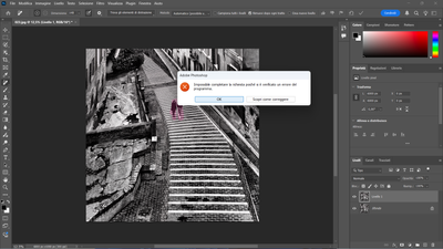

App version: Photoshop 26.9
Platform: Windows 11 (64-bit)
GPU drivers: Up to date
Steps to reproduce the issue:
-Open any image (RGB, 8 or 16 bit)
-Select the Remove Tool
-Paint over an area
-The tool crashes with the error:
“Could not complete the request because of a program error.”
The Remove Tool used to work perfectly in Photoshop 26.8.1, and I’ve confirmed that going back to that version solves the problem.
What I tried:
– Reset all tools
– Unlocked all layers
– Tested with rasterized layers and new documents
– Disabled GPU acceleration
– Reset Photoshop preferences
– Full reinstall
– Whitelisted Creative Cloud and Photoshop in the firewall
Expected result: Area should be removed using content-aware algorithm
Actual result: Tool crashes with a program error
Can anyone help me solve this problem?
Thanks
Adobe Employee ,
Aug 08, 2025 Aug 08, 2025
Hey, @Paola38464398fpo8. Welcome to the Photoshop Community. I'll move this post to discussions. I'll need more info to help you figure this out. Please share the system info from Photoshop Help > System info > Copy and paste into a text document > upload and attach here.
I've just tried this with a larger document, and I couldn't recreate this issue with the steps you've provided. In Photoshop > Edit > Image Processing & set the Remove Tool Processing to More stable.
Also, please test and confirm if the issue exists with Photoshop (Beta). You can get Photoshop (beta) from the Creative Cloud > Apps tab > Beta Apps section.
Let me know how it goes.
Thanks!
Sameer K
(Type '@' and type my name to mention me when you reply)
Community Beginner ,
Hi @Sameer K,
As requested, I’m attaching my complete System Info in the .txt file.
Just to recap:
– The issue still occurs with “Remove Tool Processing” set to “More Stable”
– The issue also persists in the latest Photoshop Beta
– The only version where the tool works correctly is Photoshop 26.8.1
Please let me know if this has been escalated internally, or if a fix is in progress.
Thanks for your time and help!
Update: I finally solved the issue!
I launched Photoshop as Administrator (right-click > Run as administrator), and the Remove Tool now works perfectly, no more program error.
It was a permissions issue all along.
Hope this helps others too. Thanks for the support @Sameer K
