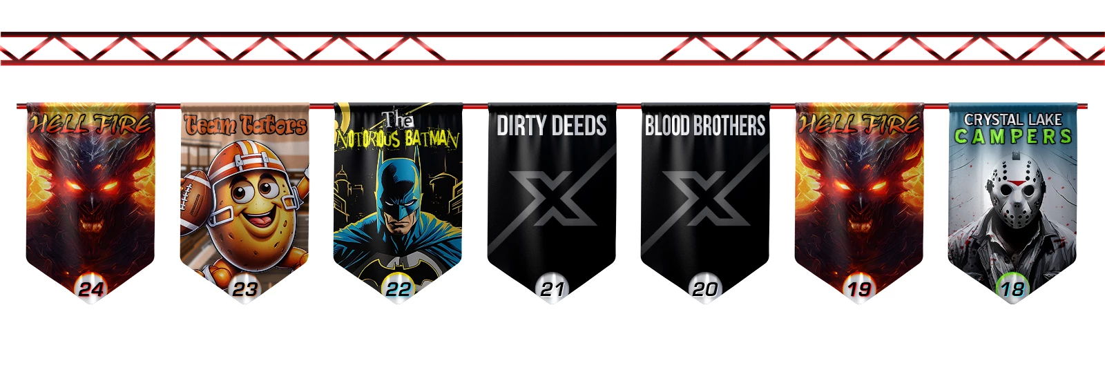

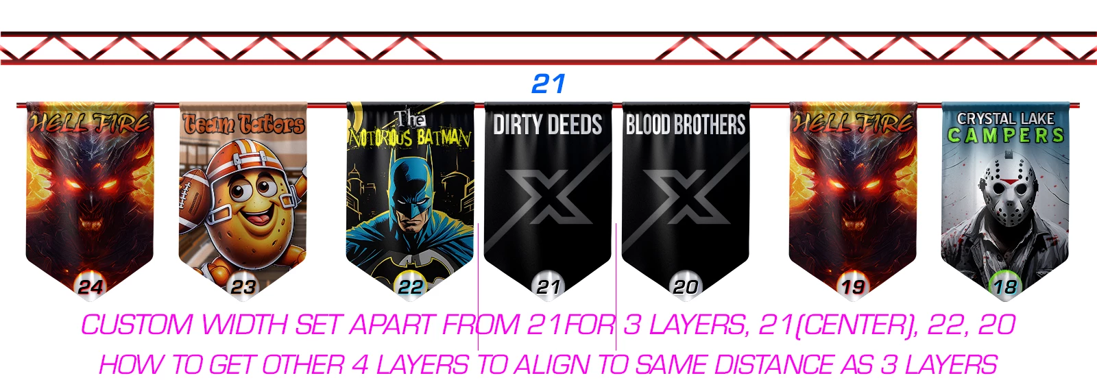

Hello Group,
I am pretty solid in PS and familiar with the distribution tool and it works nicely for setting layers at the same height or even the same width (evenly) across all layers in a row.
What i would like to know is there a way to set for example 1 layer center of the canvas and then subsequent layers to align from that center image a custom width value from it. (see examples).
I have been using guides to help me do this over the years and would like a better systematic way to do this approach if available.
Thank you
U
PS_EVEN.jpgexpand imagePS_CUSTOM_WIDTH.jpgexpand image

I think so... @umaynome  Not sure if you have text with the banners or not... so, I quickly added some movie posters with their movie titles, and group them accordingly. In my quick video. I selected the the groups. As you will see, I purposedly moved Ballerina and Freddy's over alot.... Once I select the groups in my case because I have text and a poster, I want the images and text to be positioned even through the page. I set my far poster over to the left and then the poster to the right. And then use 'Distribute Horizontally' which is also found under 'Distribute Spacing' too... not sure if this is what you mean?
If you wanted to evenly disribute it, you could select the 4th banner-5th-6th-and 7th banner and align Distribute Horizontally where you want it. And then flip over and do the sane for 1st-2nd-3rd and make it Distribute Horizontally to the 4th banner?

CE thank you for the reply and video, appreciated. However, I am aware of the distribute evenly in PS per my posting above, and if someone needed them evenly spaced that works wonders. However, i posted 5 compressed layers (no text), and what i am looking for is a way to custom set my width apart from layer 21, on layers 20 and 22, and then subesquently get the following layers 18-24 to fall in line at that custom width i set, rather then the evenly distribute width.
Hope that helps.

Ha! I found the script and found another script that does what you want, except that it doesn't center the middle layer. It just spaces all the layers on a custom value in pixels. Here it is. For it to work, you have to select the layers that you want distributed.

Nice, thank you again! I will try it out tomorrow and see how it works. The center default layer I automatically center it on the canvas myself so that isn't a issue.
Feb 08, 2025 Feb 08, 2025
Well, after using the script, it will move the centered layer, so you would need to to select all the layers and snaps the group to the center. Not a big deal.
Contributor ,
Adobe has improved PS nicely, if they could take the distribute function to allow custom define pixel width, that would be all one would need here! The distribute evenly across is cool, but that would be one step better by pixel definition
Contributor ,
Feb 09, 2025 Feb 09, 2025
This works but not as intended of course, it took 7 layers and resized them but left one of the seven resized off a bit from the entered value and other layers. Appreciate the share and effort here, I think in time PS will add this or AI will get smarter to understand better and make it work. I tired AI and it blew the art off the canvas (4) layers and left (3) layers on canvas. We shall do this manually for now.
