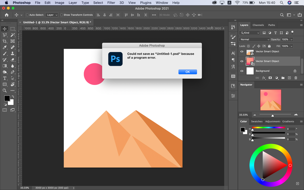

I made two really simple vector designs  and a gradient mesh in Illustrator, and as soon as I try to use it in Photoshop, I can't.
When I place the vectors into Photoshop, I can move them around, resize them etc. without problem, but as soon as I try to use the gradient mesh as well, it goes crazy. On the main screen I can't see the gradient mesh, however it shows up on the side inside the navigatior box:
And the other problem I have, if I try to use these I can't save my documents, neither on my computer or on the Cloud:
Also, when I'm trying to save my work, Ps freezes and crashes, and I don't understand what's wrong because I didn't have this problem in the past.

Yes, I have turned off the "Use Graphic Processor" option, then relaunched the program, but that didn't have any effect on the issue, so I turned it back on. I also went through the links you've provided, and the only thing that seems to make things better if I turn off the layer visibility, then I can save the documents without any problems, however the gradient mesh is still not working.
I noticed that after I deleted the default background layer, the gradient mesh layer shows up on the main screen, but when I try to resize it, I can't see the changes on the screen, just on the side in the Navigator Box.
If I toggle off the layer visibility and save the file and load it back, then it shows what I've changed, but this is such a compilacted and tiresome way to work.
