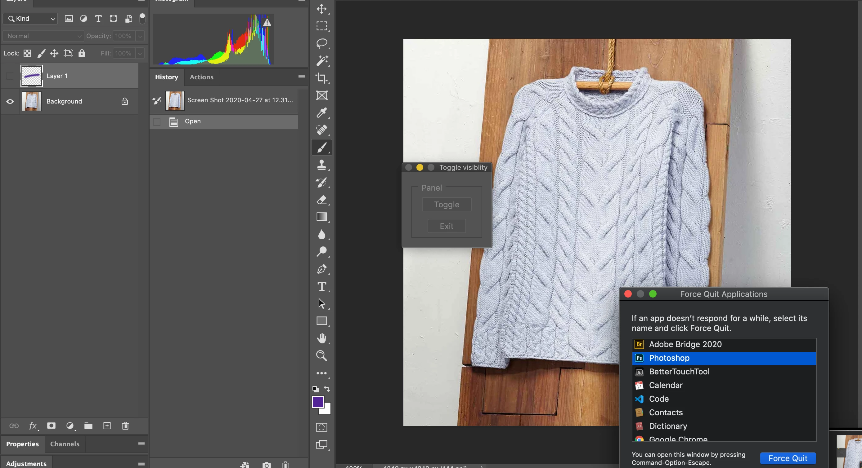

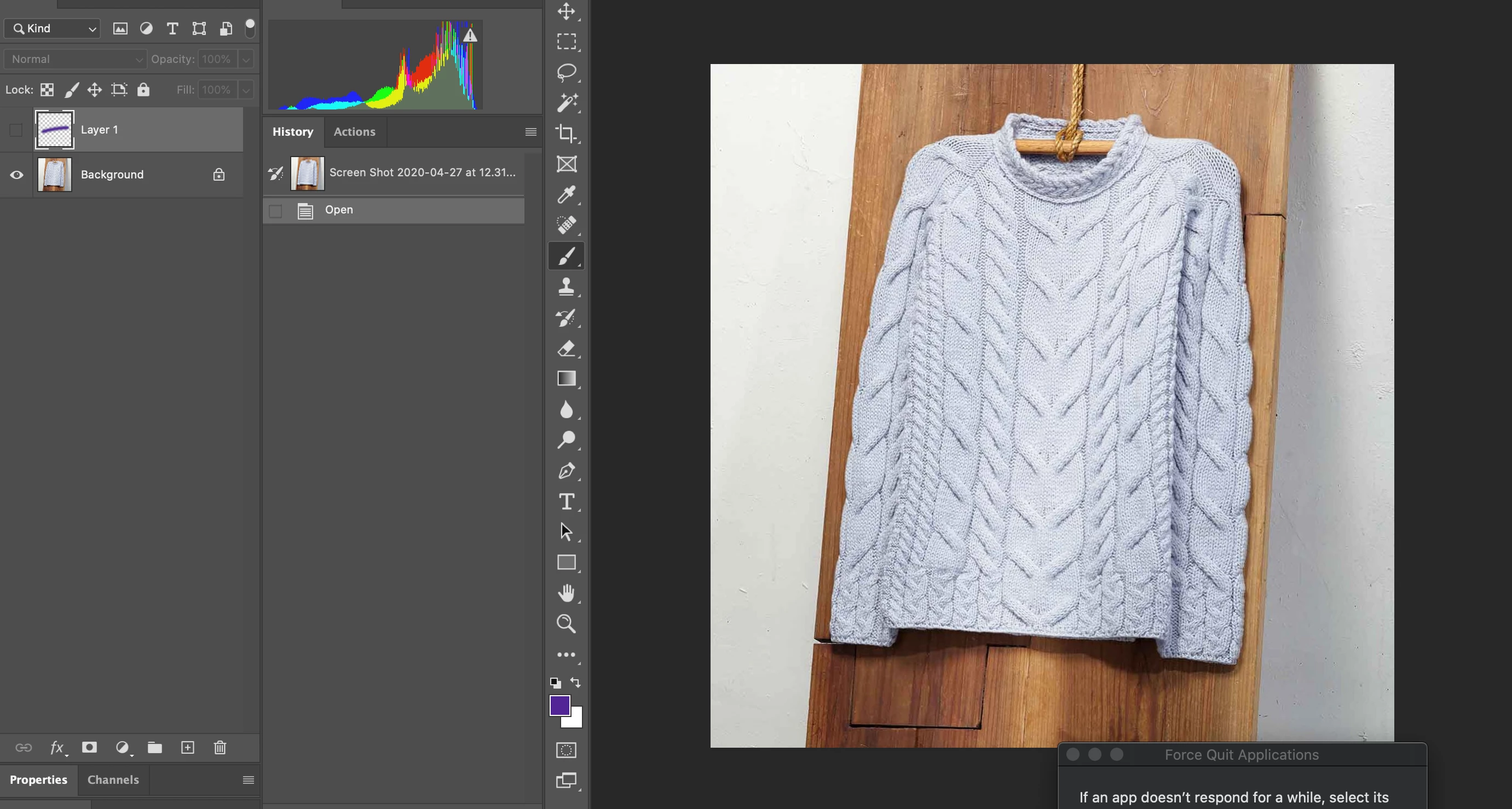

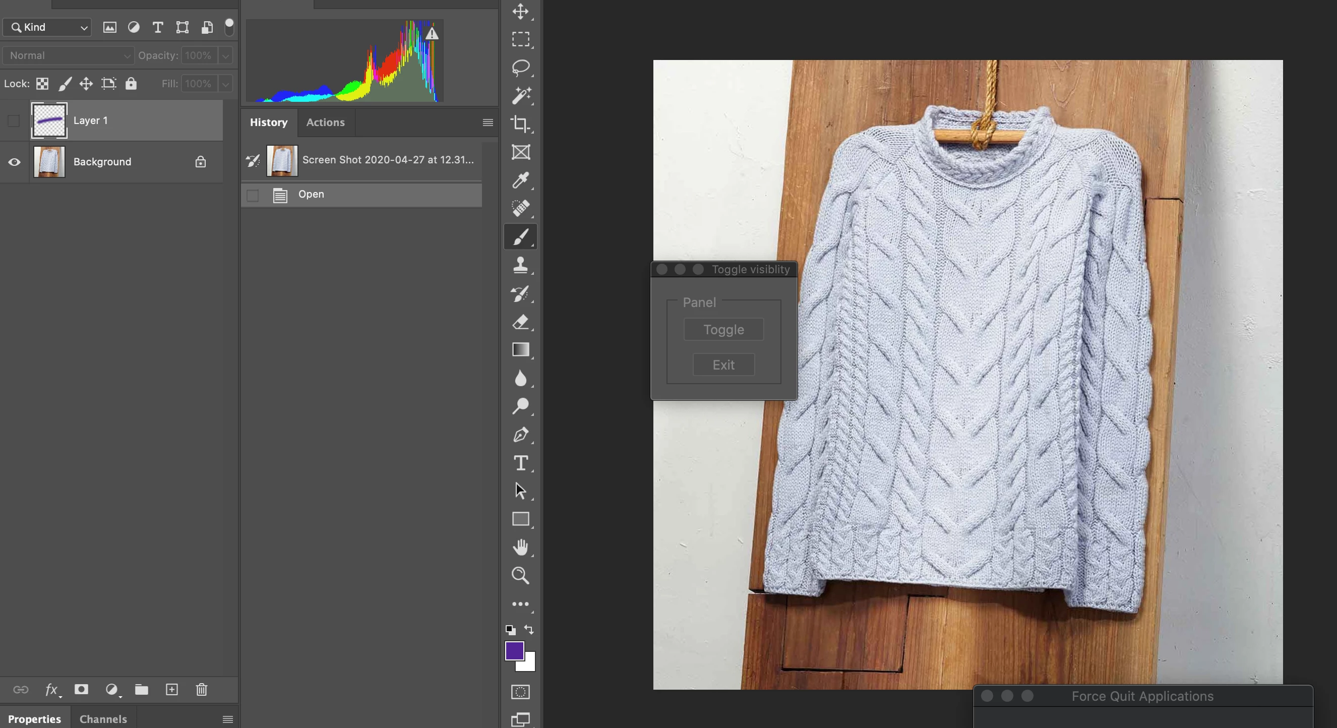

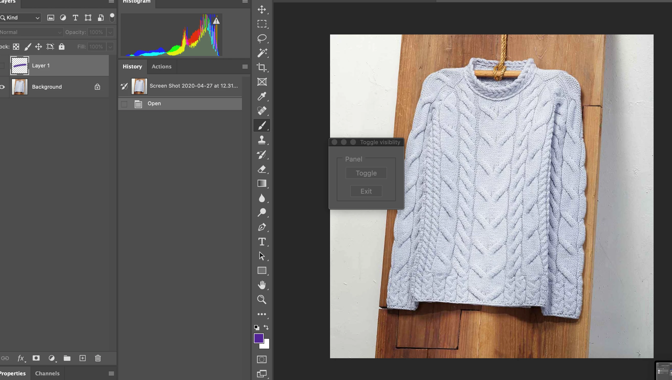

Here is a sequence of screenshots that illustrate the process with the palette UI.
Wondering if it is possible to achieve a toggle effect with a Photoshop HTML panel?
1-Run script
2- Toggle button
3- Close palette button
4-Change application focus
4- Return application focus to Photoshop.
Palette UI persists.
Close button does not work.
5- Force quit Photoshop to close palette.

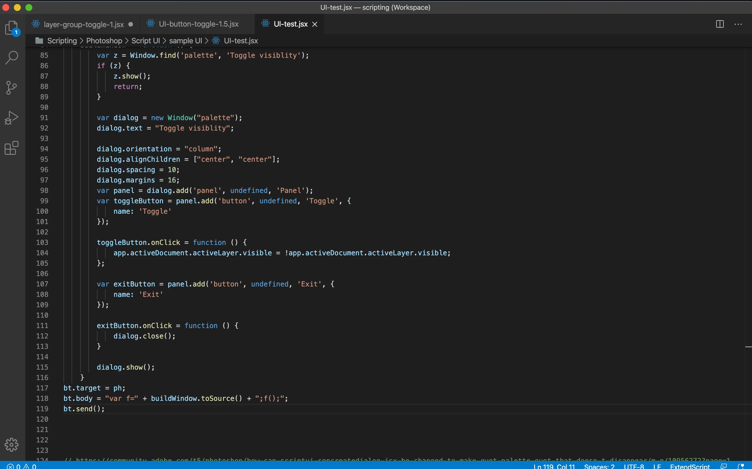

Trying to find out if it is possible to create a toggle button in a script UI dialog.  The idea is to have the dialog open and use the toggle button to switch on/off the visibility of a specific layer in a layer group.  In the example below the toggle button turns on the visibility of the adjustment layer Hue/Sat and closes the UI.

It makes sense but still lost with Bridge scripting. How would you wrap the functions and variables in the bt.body? The following codes creat an undefined alert.
var toggleButton1 = panel.add('button', undefined, undefined, { name: 'toggleButton1' });
toggleButton1.text = "Layer 1";
toggleButton1.onClick = function () {
var theLayer = toggleButton1.text;
lyrToggle(theLayer);
bt.target = ph;
bt.body = lyrToggle(theLayer);
bt.body = "var f=" + buildWindow.toSource() + ";f();";
bt.send();
function lyrToggle(theLayer) {
alert(theLayer);
Unfortunately, I do not have now much time to help you in detail. Try to output the text bt.body to file:
 f = File(Folder.desktop + "/independentlyExecutableFunction.jsx");
    f.open('w');
    f.encoding = 'text';
    f.write(bt.body);
    f.close();
This will help you understand exactly what code is using BridgeTalk and what needs to be added to it so that it can do whatever you want.
