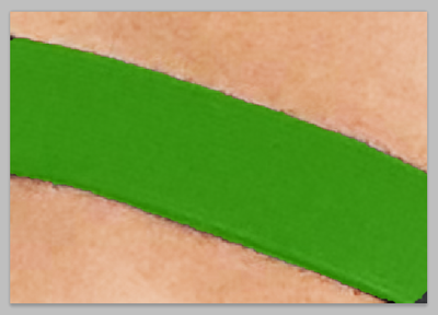

As you found, using the usual selection methods copies the nasty rough edge of the black stripe.  I've made the selection and turned on Quick Mask with colour set to green because the normal red is lost against this background).
But there is a trick we can use to help with those edges using Quick Mask.  It will not be perfect or as good as using the Pen Tool though, because it will round off the corners.  Let's see how it works.
By applying Gaussian blur to the Quick Mask we can smooth out the edge, but it will also blur the edge of course.
(Hah!  Image pasting is working for me this time)
We can then curves or levels to harden up the blurred edge.  In this case I used Levels (Cmd L) but did not move the black and white sliders all the way in because we need to maintain a degree of 'anti alias' or we'd have a stepped edge with the dreaded jaggies.
I actually went in and repeated the blur and Levels steps to further smooth the outline with gave this result.  I had expected to need to use Select > Modify > Expand as Chuck suggested, but it turned out not to need it.
The bottom line here is that making a clipping path with the Pen tool is usually the best approach with graphic like outlines.
