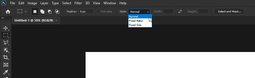

Hi
Check the options bar, you have a Fixed Size set
Change it to normal

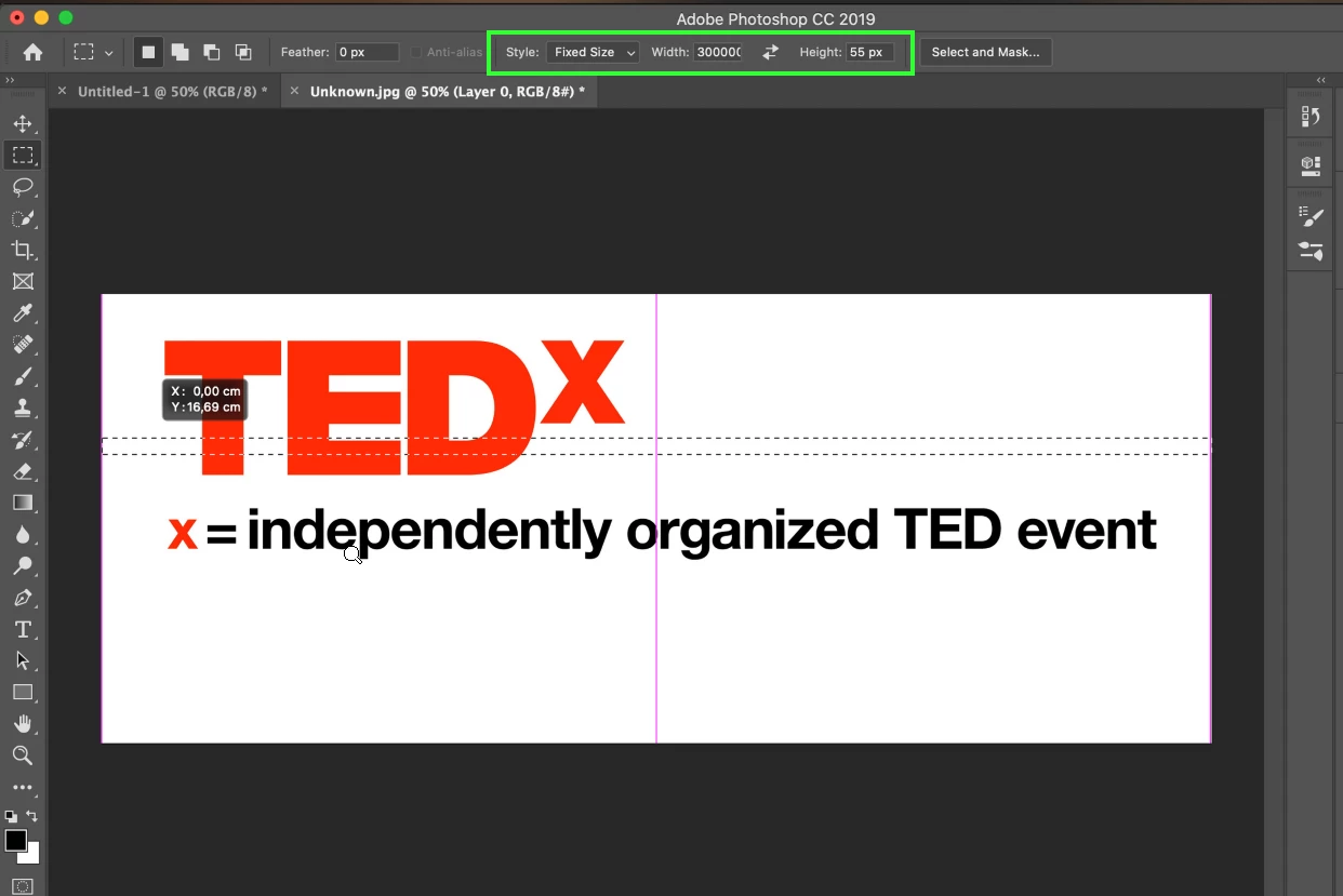

TnaTmrAuthor
November 20, 2019
I am linking the screen shot below. I recorded a screen capture but I cant link it. Hope this helps.

Hi
Change it to normal
