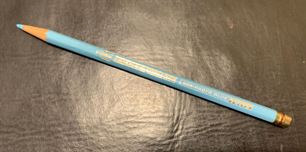

Frankly, if you're doing this type of work, you should be making your grid with a non reproducing blue pencil. Super easy to remove.
jane-e
May 7, 2022
@Chuck Uebele wrote:
...you should be making your grid with a non reproducing blue pencil. Super easy to remove.
I still have one of my non-photo blue pencils from pre-computer days, Chuck. Back then we didn't have to remove the markings when we took it to the print shop.
Jane
Chuck Uebele
May 7, 2022
Yes, I used to do a lot of layups and camera work, using that pencil.
