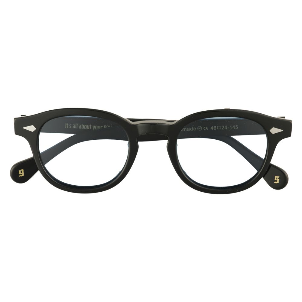

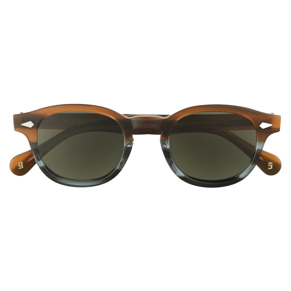

Thanks for the samples. The front-on-view images must be processed separately from the angle view, which is no surprise.
When you colour correct and retouch, are you also removing the background so that the subject is on a transparent background?
Due to the variable nature of the lenses, it is hard to automate the selection using an automated method such as Select > Select Subject between images 7R508041.JPG and 7R508042.JPG. You can try this yourself and see what happens with the lens selection compared to your final examples.
If the automation starts from a transparent background on the original sized images, that would be best.
You wanted to learn, so can try a similar approach as below for the angle view shots.

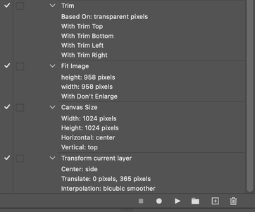

For the front-on view, then it is just a case of:
  1. Trim to transparency
  2. Fit image 958x958px or whatever is the average/common width
  3. Resize canvas 1024x1024px from fixed top-centre
  4. Transform the top of the glasses layer 365px down from the top
Which can all be performed via an action, ensuring consistency for all images when run via File > Automate > Batch. I'm happy to share the action if you want it. It will also depend on whether you are batching to keep the layered files, or batching to save the final images.
Here are examples of the action output:
Notice how the Select > Select Subject command has had problems with the lighter-toned lenses:
