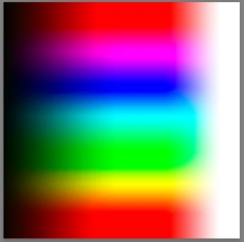

    Screen:

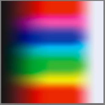

    Proof using my profile for the Epson as shown above

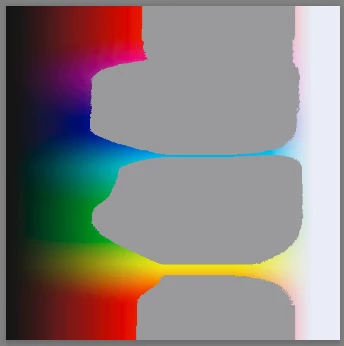

    You can also switch on the gamut warning (View Gamut Warning )and it will show the unprintable colours as a grey overlay.
    If you are only dealing with 16 colours you can choose to just allow the color management conversion to replace them with printable colours (as shown by the soft proof) or you could change the colours in the document to printable colours manually.

    The problem is simple - light reflected through coloured ink on paper will never be as bright as light emitted from a screen. So you will not get those very saturated screen colors in print.
    You can predict what will show if you are using a color managed workflow where Photoshop is managing the color for printing and you are using the correct color profile for your printer and paper combination, and you have a correctly set up and profiled display.
    If so, go to menu View > Proof Set up and select the profile for your printer and paper.
    Then check View>Proof colors
    You will immediately see the colors dull as only the printable colors will be used. How the colours that are unprintable are mapped to printable colors depends on the rendering intent that you choose.
