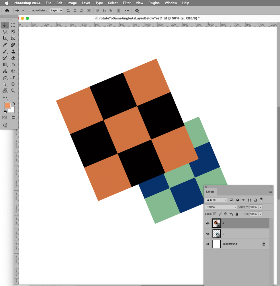

// Rotate the selected layer to match the layer below
rotateLayer(iLayer, mLayerRotation);

c.pfaffenbichler
September 28, 2024
There was a mistake indeed; I updated the code, please try again.

c.pfaffenbichler
September 1, 2024
Could you please post screenshots with the pertinent Panels (Toolbar, Layers, Options Bar, …) visible?
Is the lower Layer a Smart Object? If it is not, but rather a plain pixel Layer, the concept of »rotation« would not apply because the Bounds define a rectangle with vertical and horicontal sides.
September 2, 2024
c.pfaffenbichler
September 4, 2024
This code can be used to determine the rotation of a selected Smart Object.

var theDocID = soDesc.getString(stringIDToTypeID('documentID'));
var size = soMoreDesc.getObjectValue(stringIDToTypeID('size'));
//checkDesc2 (soMoreDesc);
var transform = soMoreDesc.getList(stringIDToTypeID("transform"));
var xx = new Array;
for (var m = 0; m < transform.count; m++) {
xx.push(transform.getDouble(m))
//alert ("transform\n"+xx.join("\n\n")+"\n\nangle "+getAngle([xx[0], xx[1]], [xx[2], xx[3]]));
var nonAffineTransform = soMoreDesc.getList(stringIDToTypeID("nonAffineTransform"));
var yy = new Array;
for (var n = 0; n < nonAffineTransform.count; n++) {
yy.push(nonAffineTransform.getDouble(n))
alert ("nonaffinetransform\n"+yy.join("\n\n")+"\n\nangle "+getAngle([yy[6], yy[7]], [yy[4], yy[5]]));
////// radians //////
function radiansOf (theAngle) {
return theAngle * Math.PI / 180
////// get an angle, 3:00 being 0˚, 6:00 90˚, etc. //////
function getAngle (pointOne, pointTwo) {
// calculate the triangle sides;
var width = pointTwo[0] - pointOne[0];
var height = pointTwo[1] - pointOne[1];
var sideC = Math.sqrt(Math.pow(width, 2) + Math.pow(height, 2));
// calculate the angles;
if (width+width > width) {theAngle = Math.asin(height / sideC) * 360 / 2 / Math.PI}
else {theAngle = 180 - (Math.asin(height / sideC) * 360 / 2 / Math.PI)};
if (theAngle < 0) {theAngle = (360 + theAngle)};
//	if (theAngle > 180) {theAngle = (360 - theAngle) * (-1)};
return theAngle
