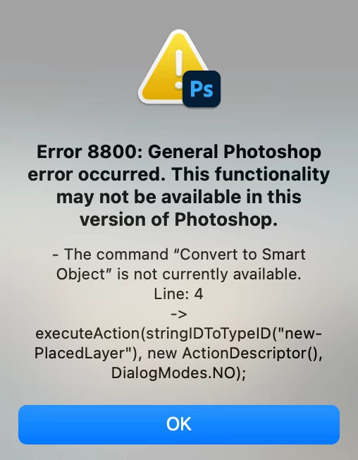

Is it possible to rewrite the script, so that photoshop selects the top layer (In my case a Artboard group) ?
When using "select --> All layers" i get a error (See attached) But if i manually select the top artboard, the scripts runs perfect!
This is my current script, and i think i just need to add a "select top group" kinda code.
By @Simon3344797511r3
Is the problem that no artboards or layers are currently selected before running the script (your sample PSD had a layer selected, so I wasn't sure)?
If so, you can add the following code to ensure that the very top layer is selected:
activeDocument.activeLayer = activeDocument.layerSets[0].layers[0];
activeDocument.activeLayer = activeDocument.activeLayer.parent;
I'm guessing that you only need this once, before the while loop to ensure that the top artboard is selected, before the script loops over and rasterizes the artboards.
