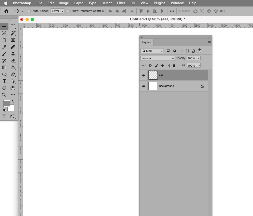

Then you need to duplicate the top Layer times the number of other layers, move one duplicate in front of each of those other layers and merge.
Selecting a Layer and merging it to the Layer below should maintain the lower Layer’s name anyway.
Community Beginner ,
Apr 05, 2023 Apr 05, 2023
thanks for your reply - adding a layer on top and merging, gives the new layer the same name as the layer on top 😉
Not here.

My merge down does the following
