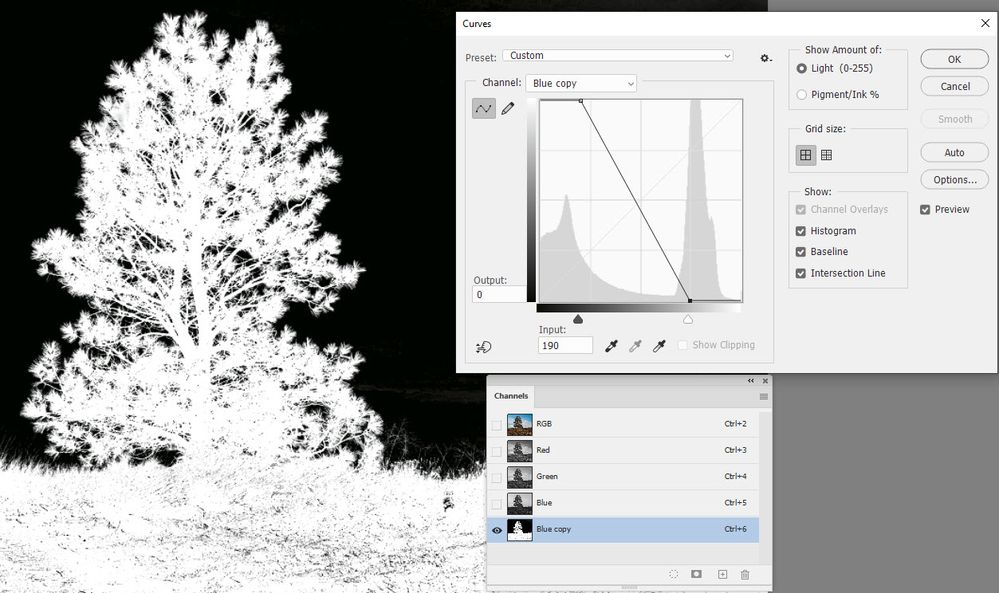

Community Expert , Feb 21, 2020 Feb 21, 2020
Try making a selection from the blue channel.
1. In the the channels panel duplicate the blue channel
2. Select that duplicate channel and use image adjustments curves set as shown below so that it inverts and makes the tree and ground white and sky black
3. Paint in black over the ground leaving just the tree (you are painting on that duplicate channel)
4. Load the channel as a selection (click the dotted circle at the bottom of the channels panel) and turn back on the RGB channels
You can now use your selection to add an adjustment layer or make a mask etc
Dave

Explorer ,
Thanks very much I will try this.  I'm not sure how to make the curves tool come up when I'm working in the Channels, but I'll figure it out.  Thanks again.
Just select the duplicate channel (make sure the other RGB channels are off using the eye symbol) and then go to menu Image > Adjustments > Curves (or press Ctrl+M)
Dave
Explorer ,
Want to thank you very much.  This absolutely worked and I learned a lot from doing it.  I even tried kind of reversing the curves to select the sky and made a few adjustments there.
Again, thank you very much.
You're welcome. If there is good contrast in a channel then it is often a good starting point for a mask/selection.
Dave
