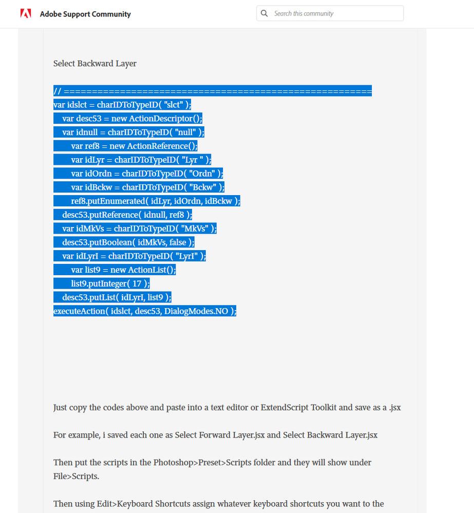

Dec 09, 2021 Dec 09, 2021
Trying to run the script gave me
"Error 25: Expected: ;.
Line; 35
-> Select Backward Layer
So I tried instead to record two actions where I select above/below layer (had to switch keyboard layout mode to US for this) but that only allows me to use the F keys as shortcut. Guess I'll just try to make it a habit to use US layout whenever using photoshop (alt+  å  and  ¨  keys then become the equivalent of brackets by default)
When you copy the script, just copy the part below where it says Select Backward Layer or Select Forward Layer like shown below:
