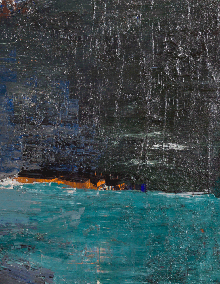

Hi Everyone,
I have spectral highlights from lighting an extremely textured painting on location.  I'm trying to find a way to reduce those highlights without actually altering the painting too much or taking away from it's texture.  I've mostly tried to work on it using the clone stamp on 'darken'.  Not sure if there is a better way.

Can you crop a small area and post it as a single layer tiff so we can see what you are dealing with

Hi
That is nasty.
You can take hide a fair bit by duplicating the layer setting the duplicate layer to 'Darker Color' then nudging the duplicate 1 px to the right and 1 px up using the right and up arrow keys. You could try 2px to the right but any more and you start to see a duplicate image.

Is it only me that sees a shark in the water?  🙂
Dave
Apr 13, 2022 Apr 13, 2022
Now that you mention it, I can't unsee the shark 😊

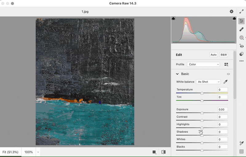

Have you tried applying the Camera Raw filter (Filter > Camera Raw Filter), and reducing the Highlights and/or Whites values? The demo below shows this being done to the entire image, with a before/after toggle comparison at the end.
If you want to restrict where it’s applied, you can do it quickly by using the masking tools inside Camera Raw. For example, you could apply a Linear Gradient mask to restrict the adjustment to the upper half, a Brush to paint it in wherever you want, or a Luminance Range mask to restrict it to the lightest tones only.
You can also enhance texture by applying Clarity and Texture adjustments with a Brush mask.
