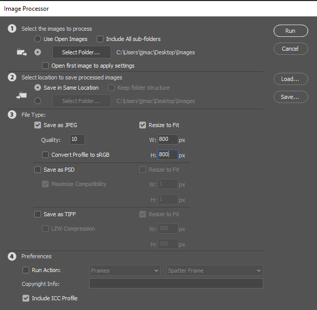

The best way IMO is to use  scripts like Image Processor and Image Processor Pro to batch your Actions and have the script  save File for the documents your actions process. Have no save steps in your action as all.
Use the Script dialog to set where you want the files save, how you want them named, the file types you want saved, The save options you want used, set resizing options, and add a copyright.  Scripts have more capabilities for saving files then actions do.

To do what you want to do does not even require an action. Image Processor pro can do it all.
And so can Adobe Image Processor menu File>Sacripts>Image Processor...

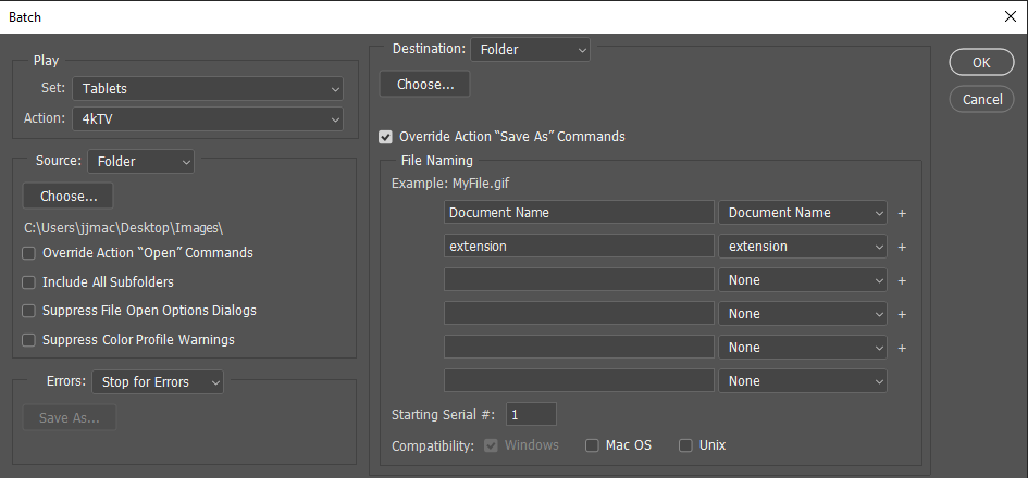

Put a "Save As" step in your action. Just name it "document.jpg" or whatever. And pick the JPEG format.
Then in the batch options ...
Screen Shot 2020-09-03 at 16.17.44.pngSelect "Override Action Save As"  and pick Document Name + extension. This will use the original name.
It says MyFile.gif, but thats just because the PS GUI people don't know what they are doing.

Solved: When recording the action, include "Save As". Give a name like "temp" or something and save to temporary folder.
When running the Batch choose: "Override Action "Save As" Commands".
File naming: Document Name, extension: extension
