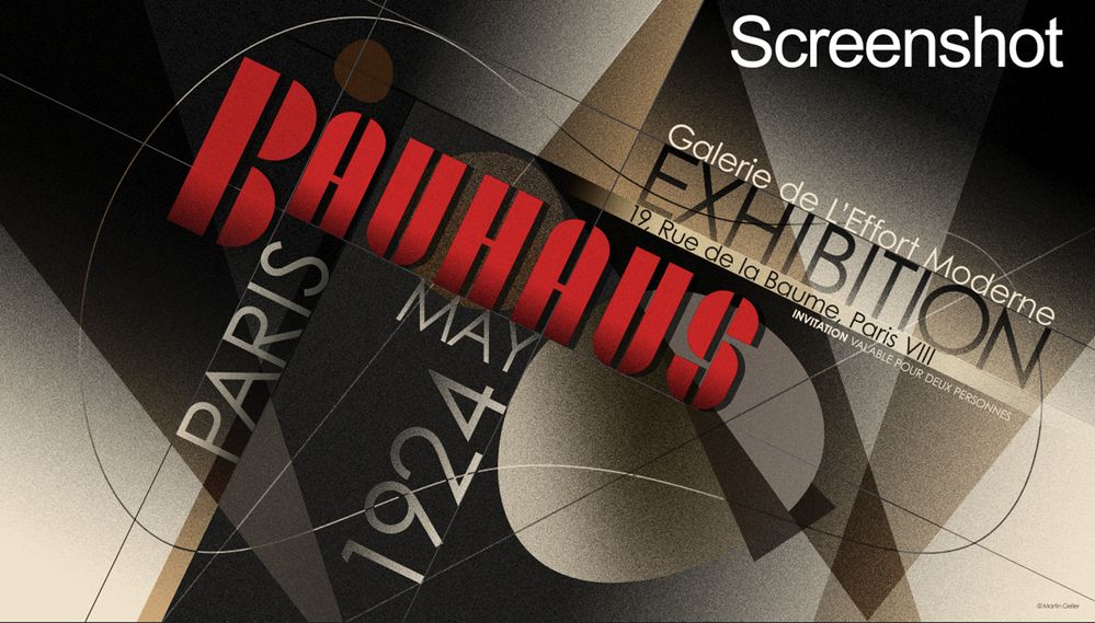

I have the same problem. I have multiple layers and folders with various blend modes applied to them. I want to be able to save the final image (screenshot) as I see it on my screen, but when I merge all the layers (Ctrl +Alt + Shift + E), the image loses the effects because the layers don't apply their respective blend modes. I know the reson why, but isn't there a way to save the funal image and retain the visual effects prior to merging the layers?merged layers.jpgscreenshot.jpg

View at 100% and try again!
The blend modes are preserved. What you see is something else.
Adjustment and blending previews are calculated based on the on-screen image for performance reasons. Zoomed out, that means a scaled and softened version. With all these noise effects, that means a lot of intermediate values that aren't there in the full data.
To be absolutely clear - the final result is correct. The preview is misleading because you don't see it at 100%.
100% is a very significant number. It means one image pixel is represented by exactly one screen pixel. This is the only true representation of the actual pixel structure.
