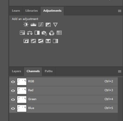

No, because I am a novice and I don't know where these things are. Channels looks like this... ???

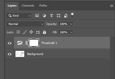

Is this the options bar?/

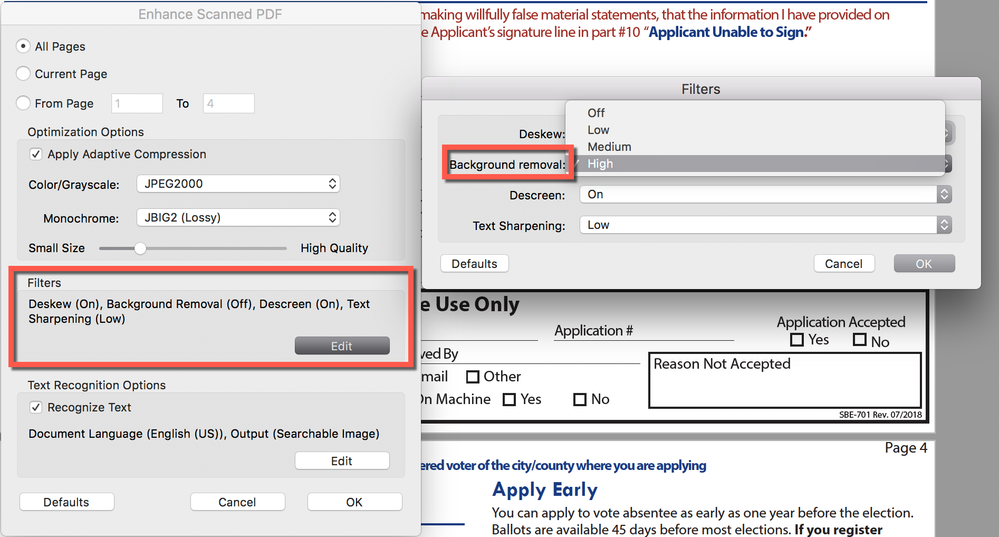

If it doesn't work, another option is to try OCR in Adobe Acrobat. There are several settings to set and I won't go through them all now, but note in the following screen shot that there is a filter for Background Removal that has four settings. That may work for you.

I think the U.K. adds VAT. There are several other settings in Acrobat OCR to be aware of, and you can export to jpeg when finished, which you said is your goal.
Ask your question in the Acrobat forum, and give a small sample if possible. Redact anything confidential — use Cmd+Drag or Ctrl+Drag to mark for redaction since it's on a scan.

Your screenshot shows you have two layers. A layer containing pixels which in your screenshot is labelled background and an adjustment layer, in your case a threshold adjustment layer. The first contains the image pixels, the second contains only the adjustment information telling Photoshop how to display the pixels below it. The adjustment layer does not contain any actual pixels, and importantly no permanent changes are made to the pixel layer below it.
If you save your document in a format that supports layers (e.g. PSD or TIFF) then both those separate layers are retained and the document can be reopened and the adjustment layer re-adjusted.
If you merge layers or save a copy in a format that does not support layers, then the adjustments are made permanently to the pixel layer before discarding the adjustment  layer and you are left with a single pixel layer which has those adjustments permanently baked into it.
When using Photoshop, adjustments should always be checked at 100% zoom, which is not a physical size but means means 1 image pixel mapped onto 1 screen pixel. This will always match before and after merging.
