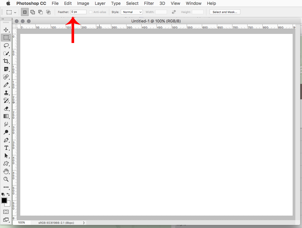

First thought that comes to mind is some feathering other than 0 px (zero) was set in the tool options bar for the particular selection tool before you made the actual selection.

Example of Feather for Rectangular Marquee Tool

I thought of feathering but all feather options are set to 0. I used quick selection tool.

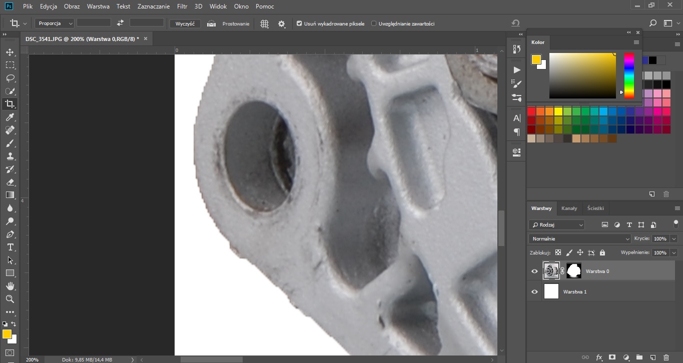

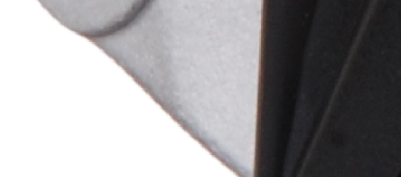

Okay I've got an example for you.
This is how it looked before
and this is how it looks now

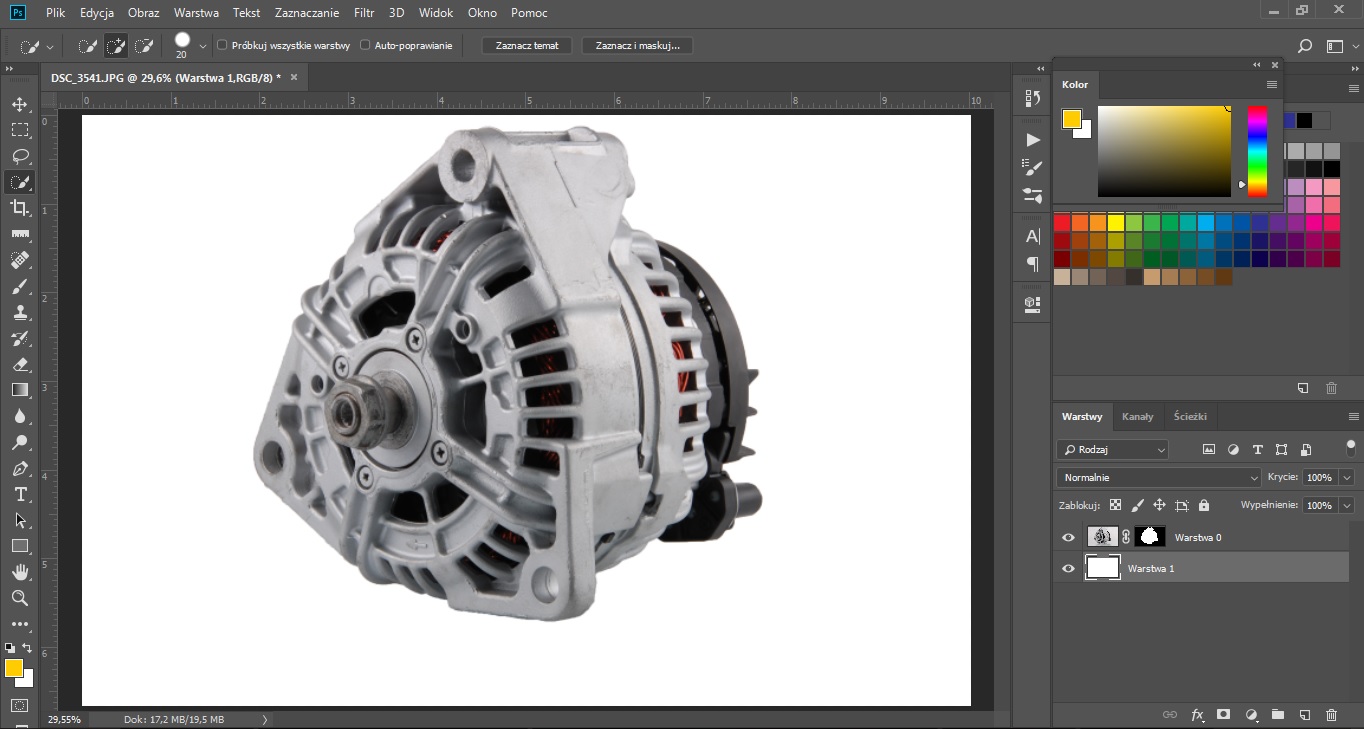

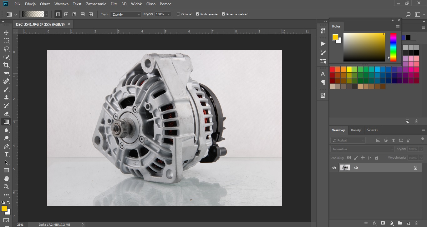

Apr 18, 2018 Apr 18, 2018

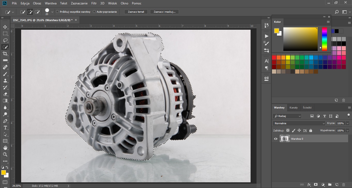

1. Load picture to Photoshop
2. Unlock layer and select object with Quick Selection tool
3. Use mask and add white background

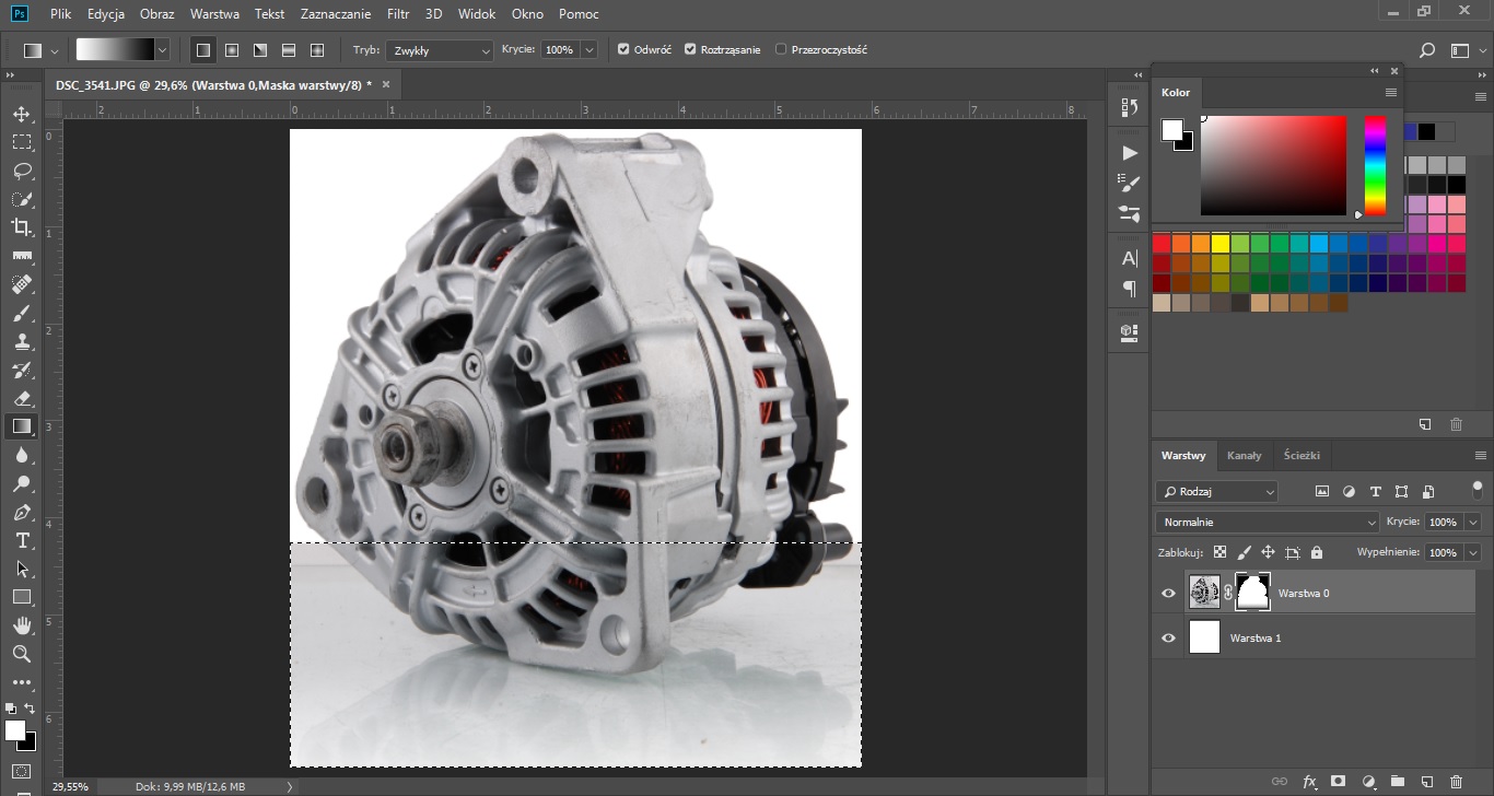

4. Crop image, use Rectangular Selection tool, select layer mask and use gradient to reveal some of the original background
5. Load earlier saved selection of the object. While still being on the mask, remove unnecessary background with gradient.

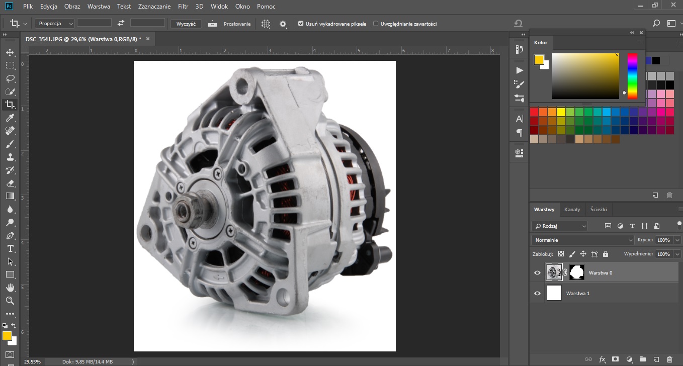

6. Effect
Hope it helps now

Thanks for the screenshots.
In my opinion you employ a bad technique.
By loading the Selection that is identical to the original Layer Mask (or its inverse) and editing the Mask you are effectively superimposing two 8bit images and that can cause noticeable degradation.
I recommend you instead duplicate the image Layer and place the lower instance in a Group, apply Layer Mask to the Group for the gradient and then paint on a wholly new Layer Mask for the Layer in the Group.
This will result in a larger file (twice the pixel Layer, three Layer Masks) but the editiability of the individual Masking components should be useful.
(Actually a Group with a Solid Color Layer, a Gradient Layer and the image Layer Clipping Masked to the Group could provide the same result, but that may not feel as comfortable.)
